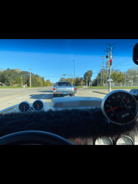

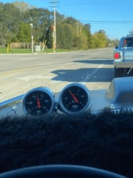

Good advice. I’ve always run them and now thinking about it you’re correct. Why risk the fire. I was going to install one on my newly acquired road runner, but you changed my mind. It never gets looked at unless you have a fuel pressure regulator and are adjusting fuel pressure, which setting the fuel pressure is like using a RonCo Chicken Rotisserie, “set it and forget it”.
