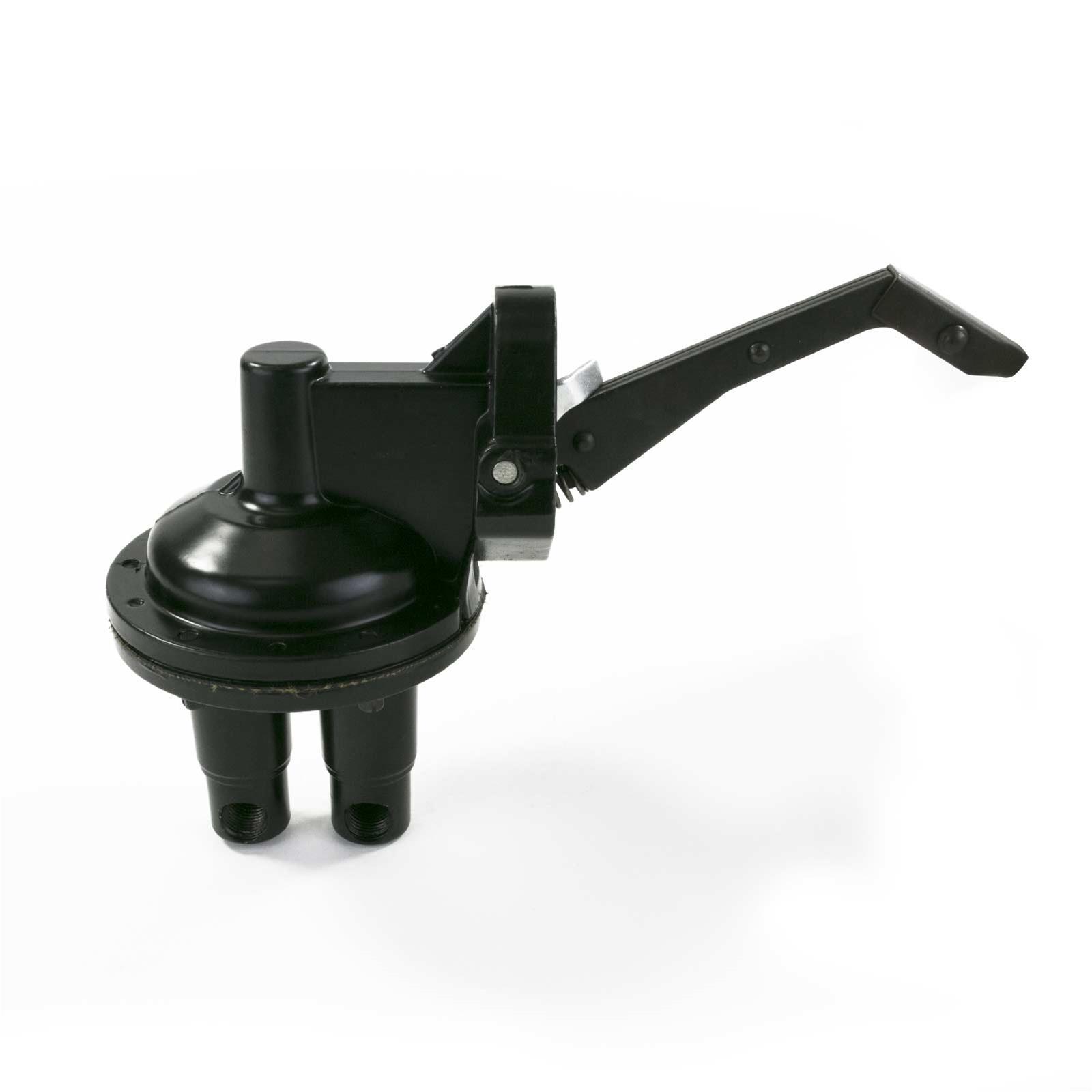

HI,
yeah, I like the fact that they are screwed together and not just clamped.
thanks

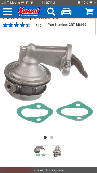

Yes they are crap. I’ve went through 2 in the past 3 months in my 440. One was a stock Carter and the other was a Delphi. I put one of these Carter high performance pumps on and haven’t had any problems so far.
I just ordered this one yesterday. I hope it's as good as what I've read!
I have the Carter hi performance pump on my small block 6-pack stroker. Had to use a pressure regulator, 7.5 lbs of pressure was a little too high. No problem with the pump otherwise.
