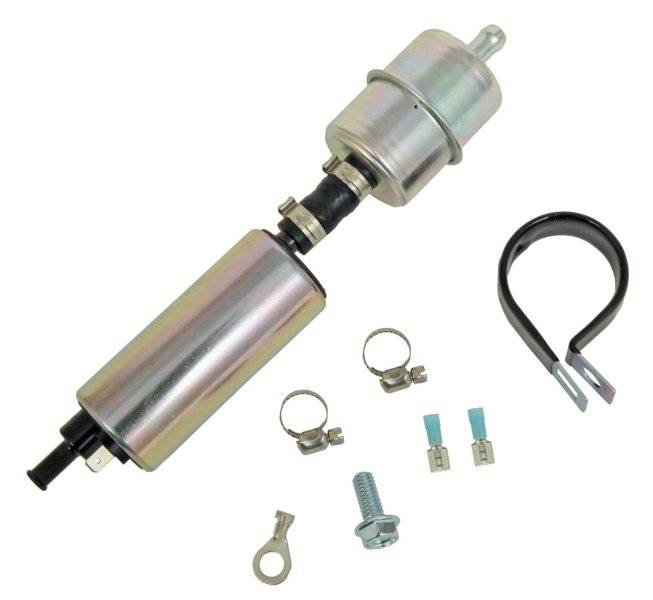

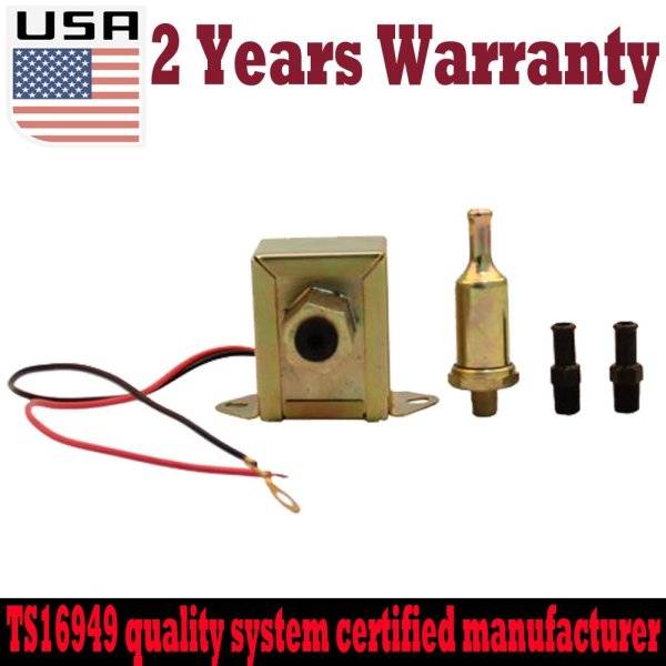

There's a part number on one. These small pumps will allow gas to pass through when they aren't running so they can be used for a charge pump. Summit has pumps. You could probably get a universal pump at a local parts store.
So I can hook these pump up Directly to my fuel line at the tank that goes to the carb
Tom
Tom
Yes. They are designed to push the fuel so they need to be by the tank.
I was just looking on Summit's site. Holley and edelbrock both have small pumps that would be perfect for what you need. They are also low pressure but that doesn't matter because you won't be running it constantly. Free Shipping on Orders Over $99 at Summit Racing
