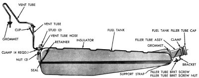

I don't even remember where the filler is on a 69 Coronet. But if it's like the RR's, --- behind the plate-- you do NOT want a vented cap!!!
It is behind the license plate.
'S what I figured. You do NOT want ANY form of vented cap on those, must be completely sealed.
The vent system on those, prior to the 70 CA vapor return and carbon can system, are very simple. Just an upside down "U" vent tube high up above the tank. It must be clear.
