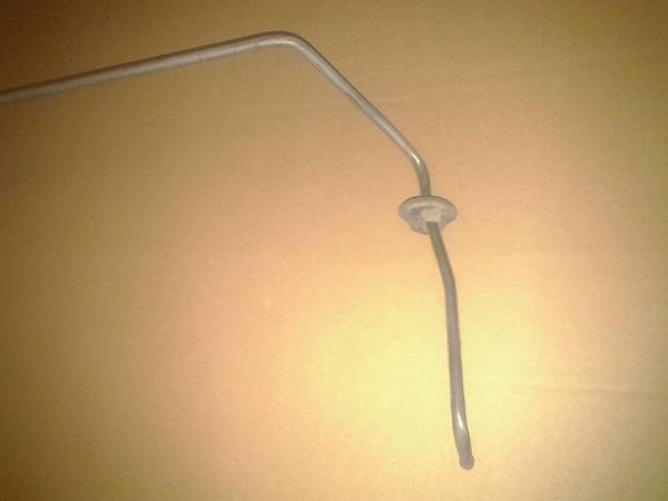

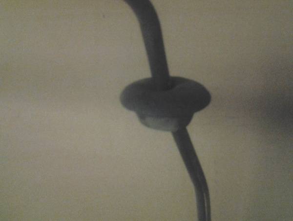

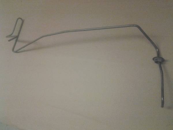

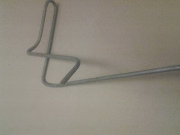

I have a really nice fuel tank vent tube from a '68 B Body with the grommet too if you're wanting to go with original.
