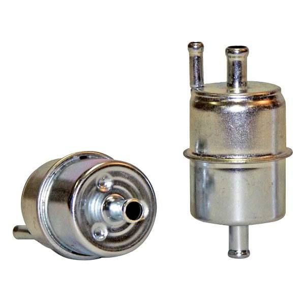

Please explain a little more. I've never run the "factory" type fuel vapor separator or a return line. I've also never seen a fuel filter with a vapor return port.

You have now - (Wix 33040 = 2 x 5/16" & 1/4" return with built in return orifice, Wix 33041 = 2 x 3/8" & 1/4" return with built in return orifice)

Thanks 62 Dart. OK, so if I'm running one (or two I guess) of these filters & a return line to the stock tank's fuel outlet at the sender (I supply fuel to both pumps with a dual outlet sump on the stock fuel tank), will that work for me to eliminate any "vapor lock"? Is this doing the same thing as the stock-style 440/hemi vapor separator?
Lastly, what do I do about the other nitrous-system supply fuel line? Can I "T" the two fuel returns? Is there no way for a the 2nd fuel pump for the nitrous to "vapor lock"? (that's what I'm thinking)
My "gut instinct" would be to ONLY use this on the engine's fuel pump fuel line & run the return fuel back through the fuel sender (capped off now since I'm pulling fuel out of the dual-outlet sump). OR, would that actually create "fuel slosh" like Hemi is talking about?

Well I had massive problems with vapor lock and one of these filters cured it for me. I would say your observed pressure drops are proof vapor is presenting at the carb float valves. To my thinking, the vapor separator should be as close to the carb as possible, and the factory set up located just after the mech pump is odd. I'm convinced my problems were in the steel line from the pump up and over the rocker cover to the carb so a V S right after the pump just wouldn't help. I would put one in both fuel supplies, and I'd say teeing the 2 return lines would be fine. Alternatively, as threewood suggested, you could use a fuel regulator with a return port, but again I'd suggest it be located as close to carb as possible. A 3 port filter or 2 will certainly be less costly to try first though!

FYI- I just ordered two 33041 WIX filters to give that a try first. I probably won't know if they do the job until next summer sitting in traffic though.

Why would you assume fuel won't vapor lock in line to nitrous system? A vapor separator in there would be cheap insurance against lean out. Install filter with 3rd nipple clocked at 12:00 position as bubbles always rise.
