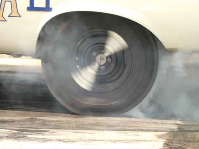

We've been running the Hurst Racing 30/10/15 pie crust slicks on our altered this past season with mixed results. If we go to a bomber facility like Mission where they run 5 second cars and the prep is usually nothing short of phenomenal then the tires work great, providing they have no time to cool down between the burn-out and launch. Unfortunately we end up running a lot of smaller less prepped tracks and these tires won't hook to save their lives.
I'm not expecting wrinkle wall performance from these tires but they're down right crappy in a less than perfect environment.

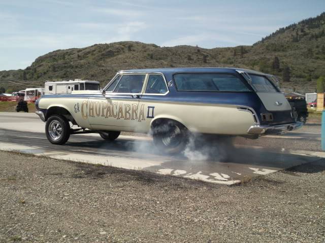

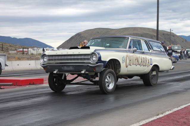

Well hell, since we went to the trouble to give you all this expert excellent advice, don't you think we deserve to see the whole car? lol
You don't have to ask me twice. I figured most folks on here are familiar with our wreck. You can also follow the entire build and racing progress to date through the blog link below.
I do love them wagons, especially when they have the 60's-70's, AWB, F/X or S/S nostalgia race car look, very cool...
The theme of the build was 1965 (the most important year in drag racing, in my opinion) By '66 the awb craze was coming to a close and pretty much forgotten by the end of the decade, which is why we wanted to use these tires. We're leaning heavily in the direction of the Phoenix slicks from Coker at this stage.
