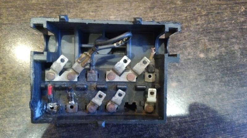

I'm currently repairing the wiring under the dash, and I'm having trouble. The fuse box was cut off from the wiring harness. I found all the ends except one.

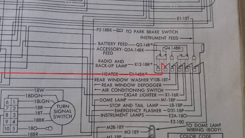

I can't find a black wire with a white stripe in the harness. Marked in red on the picture.

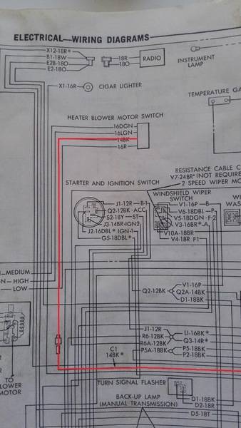

According to the diagrams from the book, this wire goes to heater blower motor But I can't even find a connector with these wire colors. At the same time, it seems that the tourniquet itself was not opened.
Where to find this wire? What does the connector look like? Thank you!
A long time, hard to remember; 4-wire harness going to blower switch and then a 3-wire going to blower resistor on heater box.
Maybe different for my 67 but the wire you highlighted is BK which is a black. IIRC wires with tracers are marked with an * after the color.
I could be wrong though...
And what does the connector look like where do you go with this wire?
