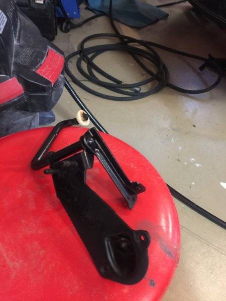

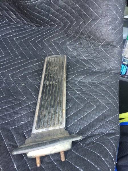

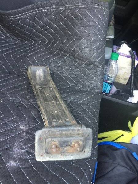

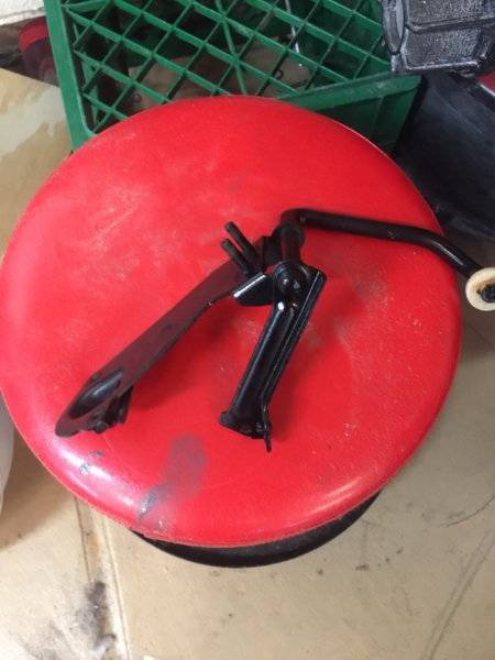

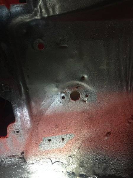

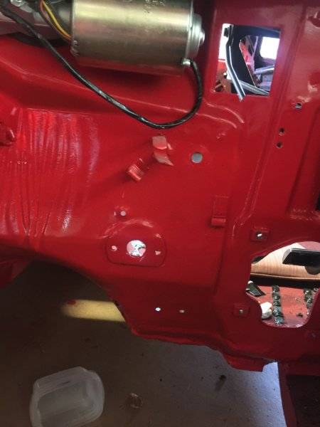

I have a 69 road runner. I have the gas pedal and the throttle bracket either I missing holes or I have the wrong parts.
View attachment 615605 View attachment 615606 View attachment 615607 View attachment 615608 View attachment 615609 View attachment 615610 I have a 69 road runner. I have the gas pedal and the throttle bracket either I missing holes or I have the wrong parts.
Throttle bracket attaches on the inside, you have the holes. Upper set with big hole in middle and bolt holes on either side + lower two holes offset to driver side (throttle bracket studs go through these).
If you replaced floor pans you will need to place the pedal in the correct spot for the ramp on the back of the pedal to get full contact from idle to wot.
Is it possible the bracket is for a different vehicle.I put it in the holes at the top the studs don’t line up with the holes on the bottom.
Try putting the studs thru the lower holes first. I just reinstalled mine a couple weeks ago and had to do it that way and then push downward to get the upper holes to line up. If it turns out you do have the wrong parts, which I don't think they are wrong, I have the correct one here that I would part with
Yes I talk to the guy that told me to park it looks like it’s wrong part the studs are probably quarter inch maybe maybe a little less too narrow for the holes in the floor thanks for all the help
