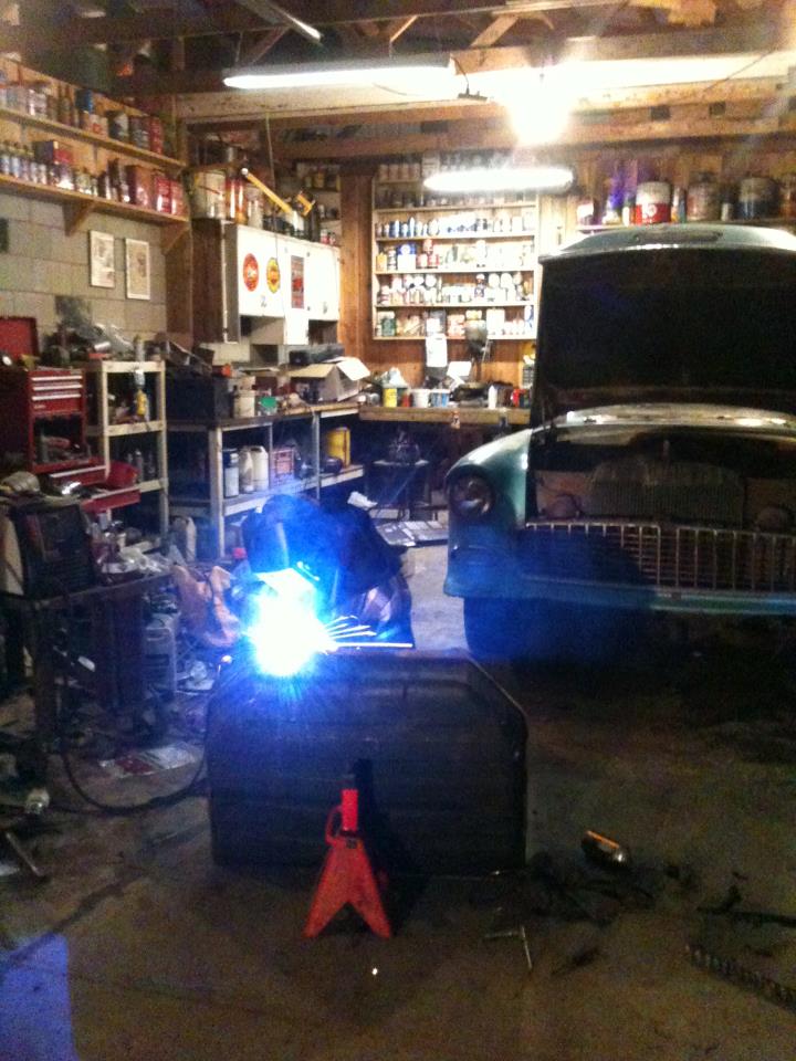

use common sense... don't smoke, don't cut the strap w/ a torch or cut off wheel, make sure there's as least amount of gas possible or you will get a gas bath.... when I replaced my fuel system not long ago I dropped the tank, cleaned it out, welded any small holes up in it, and painted it... and I didn't blow up
I just leave the strap(s) on and let the tank slowly (as possible) slide down them while holding the other (free) side.
The only downside to welding repairs in tanks, is that you loose the rust resistant coating on the weld area (both inside and outside).
Seax- how do you deal with that? I have 98% good tank with one hole I'd like to weld back up, but I'm afraid it would just rust out at the weld in a short time.
