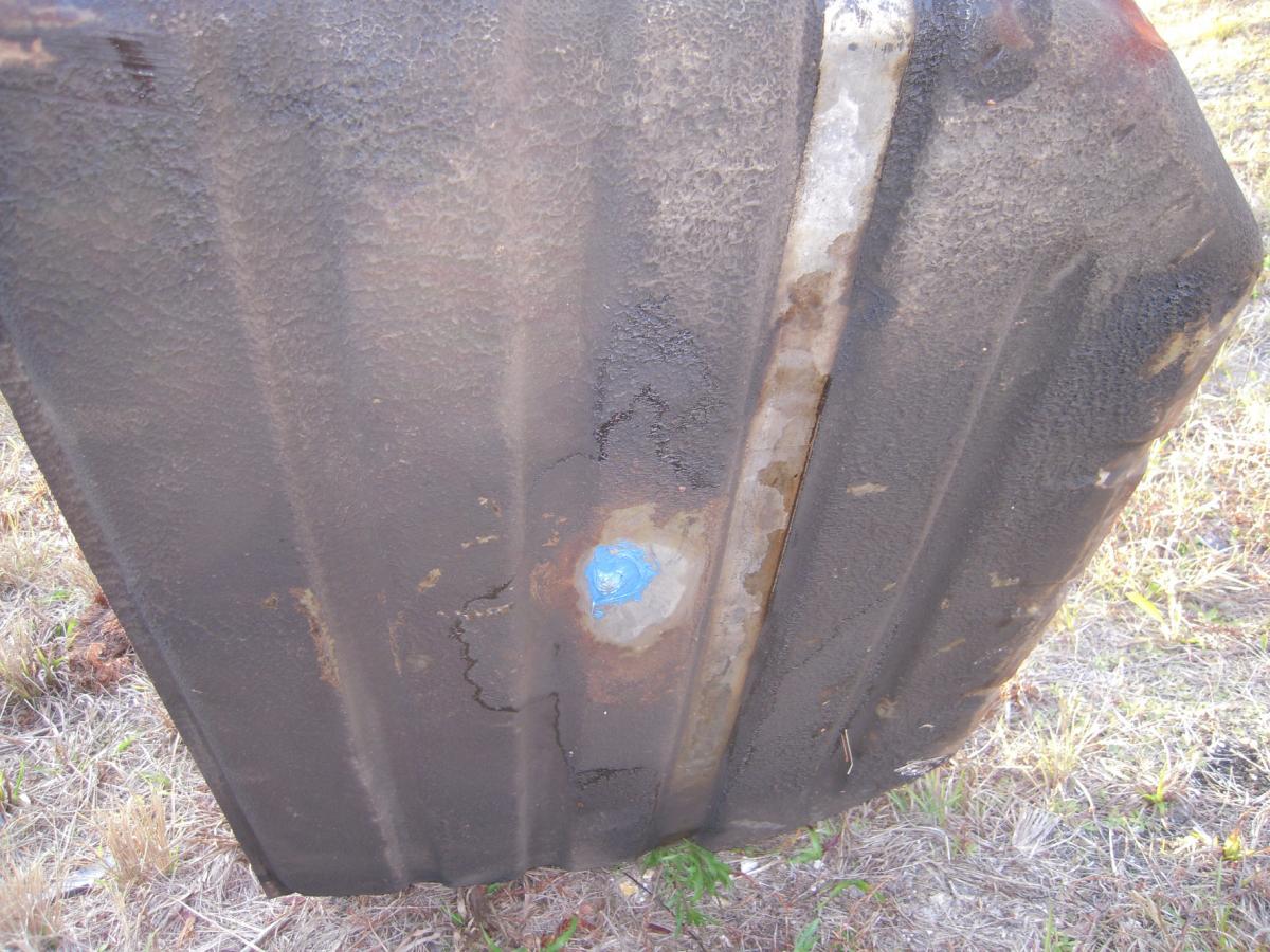

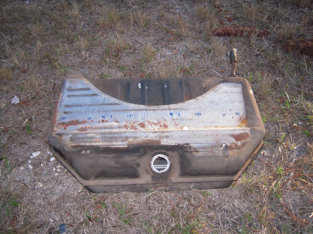

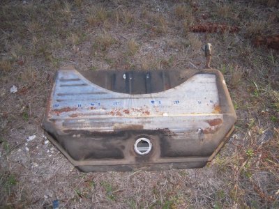

I just removed my tank today. My 66 Coronet the entire bottom of tank including strap was undercoated. My guess was the dealer did it. Even the filler tube was covered with the stuff.

so if I leave if natural, wouldnt it be a good idea to just plain clear coat it to protect it?
If you have no plating on it then yes, you should put something so it doesn't rust. POR 15 supposedly has some good clear paint. Glisten PC I think?
I think r/t specialties has the hook. I would just spray bomb some undercoating on it and call it good.
