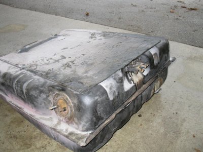

I am pretty sure this is not a 68 roadrunner gas tank. Can someone ID this please. I need to get a new sender for it and need at least a year and model LOL. It has the filler tube at the front and 4 vents at the back.
Thanks

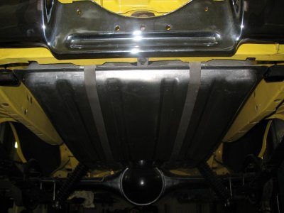

Hey Al ,I have the proper tank in good condition out of the Bee with pick-up

Gezz Rick you got everything I need LOL. The runner has major frame ties and this tank fits in there nice, the tank is ok just needs a sender. So what do you want for the tank, I can see if it fits.
Maybe swing by and have a peek at the tranny and shifter.
AL
That tank looks like a later E body one.....
That is what I was thinking but The filler tube would have been on the side where the sender is.
If Beezee tank will fit maybe I will go that route.
AL
AL
Only if it came out of a Challenger. The Cuda had the fill behind the license plate.
Sometimes ebay is good for something after looking at about 100 tanks one guy had a few shots from other angles which allowed me to ID it...72/73 Charger.
Thanks guy's.
AL
