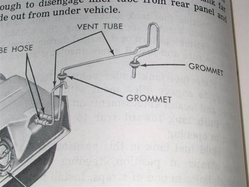

Does anyone have issues with gas leaking out the vent at the front of the tank when its full, I have a 68 RR and if I fill the tank and park it puddles. The vents are done according to the shop manual and complete, any ideas would be appriciated.

i had a new tank and had this same problem. looked inside tank and found that there is a vent line to runs almost to the filler neck. that had come loose to where it was mounted to the top of tank. took some fuel line and stuck it on the vent tube and ran it up to just under the fill cap. no more fuel pushed out the vent.

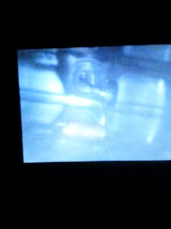

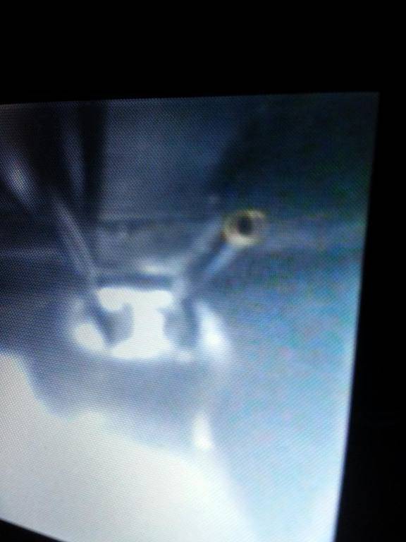

Going to re has this thread since it's summer time and we are sure to get more posts about fuel smell gas puddles etc lol Took a pic of the view from inside my tank, the vent lines at the back had tried switching them in winter but don't think it matters as it is getting warmer here and still have smell. Not as much on the ground though. I am going to try a couple of things 1 put a fuel filter on the end of the short tube see if that helps. 2 maybe find a factory charcoal canister for a ECS Cal car or 70 model. 3 try a vented cap on top of the vent lines in the correct position.
I currently have the lines reverse from the diagram so when parked facing down on a decline gas doesn't pour out the shot vent tube like it has before. that is just weird anyway. Why would it be designed like that? wondering if a filter will help the short one? maybe with smell at least.
Bad pick of the float at about 1/4 tank I need 3 hands.
