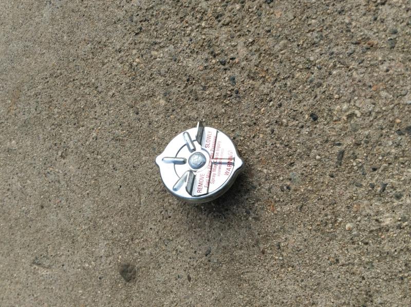

Its possible that the return line in clogged by the filler neck. I have recently replaced everything below the filler neck but did not check the return line. I am currently using the Stant 11646 cap which is non vented. I called Laysons to see if there is a vented cap for these cars and they said it should not need a vented cap. The car was designed for a non vented cap.

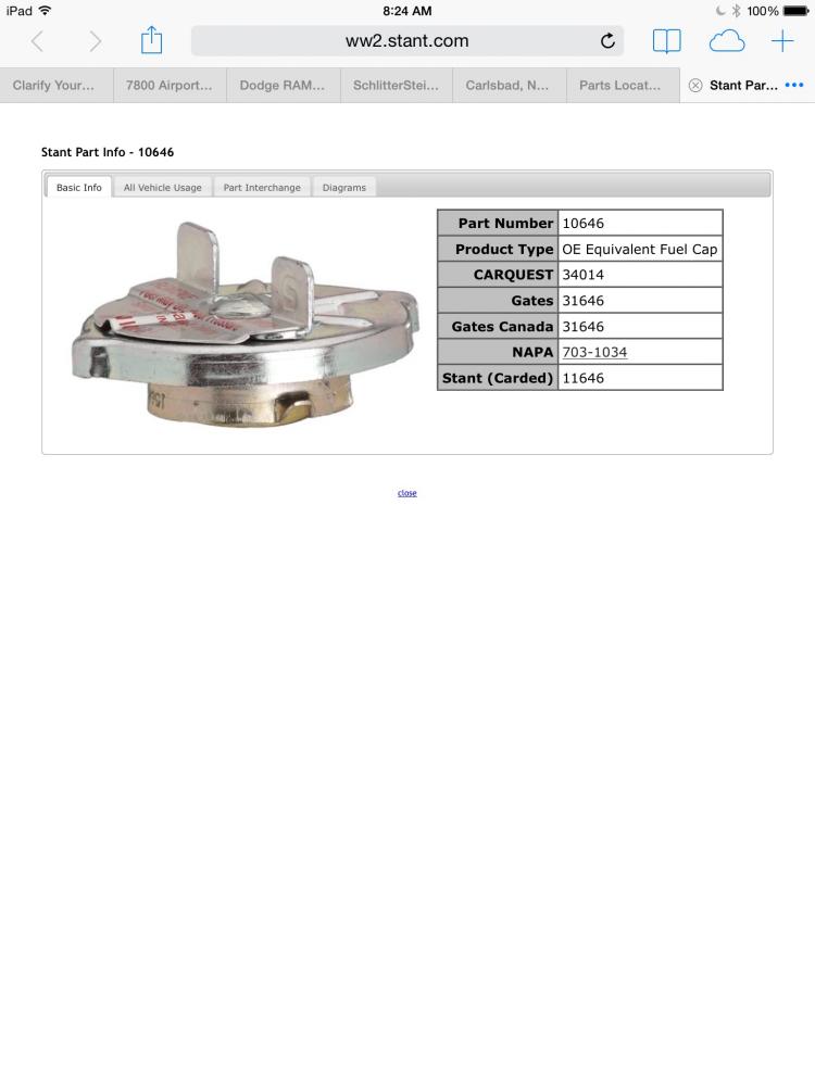

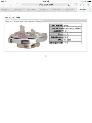

I used a Stant gas cap Vented Style. Stant.com has make/model tool to select your car.
I filtered for 66 coronet but you can do for 67. They both have same part number.
I have 3/8 supply/return lines. I just went to Autozone and gave them Stant part number that I got off site. My cap is below

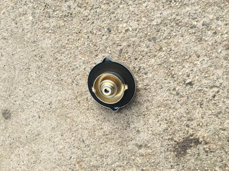

i had that prob on my 67.tank is vented by cap,no outside venting on tank.got a murry 6046(orielly).didnt do good at first,vent didnt seem to work good enough.took a pair of plyers and crushed the plastic vent assembly inside the cap.came right off.works great now.i live in vegas and gets real hot here,no probs so far.
Laysons was wrong - the 1967 Coronet gas cap was vented - original part number 2208538, it was marked 'vented' on top of the cap.

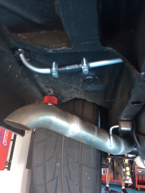

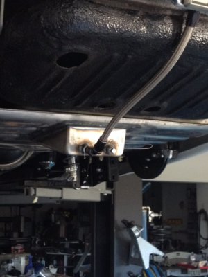

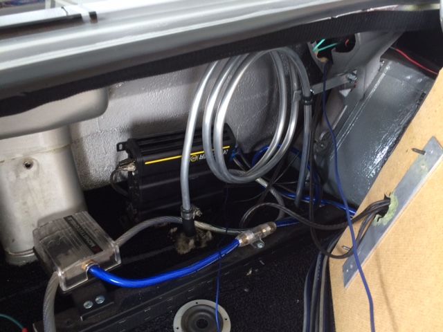

vent.jpgventtrunk.jpgUpdate on this vapor lock issue I was having. The stock system was just not able to keep up with the requirements of a 600+HP 1000CFM setup. The vented cap actually has a one way check valve and that was not allowing enough air in so I drilled an 1/8 inch hole and the venting problem was solved.......However gas was returning back through the cap and running down the quarter panel.
Solution was to reroute the vent line into the trunk and cap off the vent at the filler neck. Problem solved.
I ended up drilling my cap out as well. 2 1/8" holes in a non vented cap and all is well, have a bit of a smell sometimes after hot days parked but no spillage on the ground like before. certainly not as much hp as you but venting the stock cap worked.
That coil in your pic looks like a still! where is the moonshine?
