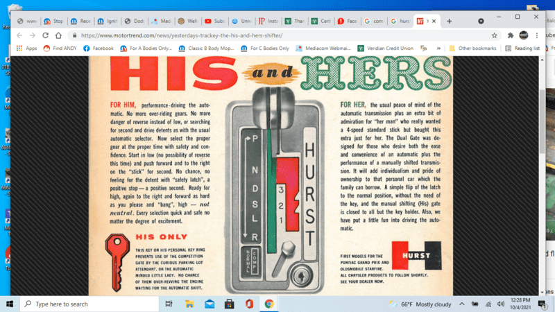

Hurst used to make a Dual Gate. I was never impressed compared to the Slap Stick.

Hurst used to make a Dual Gate. I was never impressed compared to the Slap Stick. View attachment 1175014
I wonder what in the world was the intended application for the pictured dual gate?
Reverse at the BOTTOM of the pattern, with a three speed? And reverse not available on the "race" side... so you can't back up after a burnout?
No wonder you weren't impressed!
(My guess would be some sort of "jetaway" Olds trans. Sure not a powerglide, or turbo 350/400).
