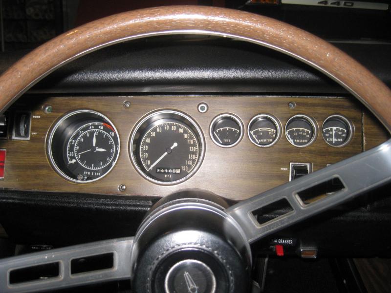

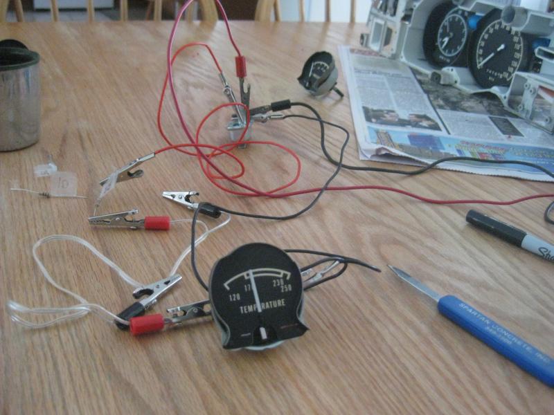

I did mine recently but I had no rust issues, cleaned the faces with alcohol, re-calibrated all, then polished the plastic lens. It made a huge difference as they where basically untouched since 1970.
