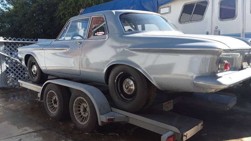

First, questions. What body style are we talking about, and what size tires do you have on it now?
I have 255-70x15 on my 62, on an eight inch rim. Bfg radial t/a, 29+" tall, rwl on the inside, 8"tread on the ground,10 1/2 or 11 "section, i dont remember for sure. If you have 25/26"tall now, they will make a difference, if you are 27 1/2, not so much. I would measure what you have now, and see if you can get a 29"+ tire on it .
