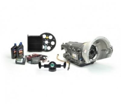

there cheap compared to one of these, the TCI 6 speed programmable auto $8200
Holy CRAP...Eight grand for a transmission???
