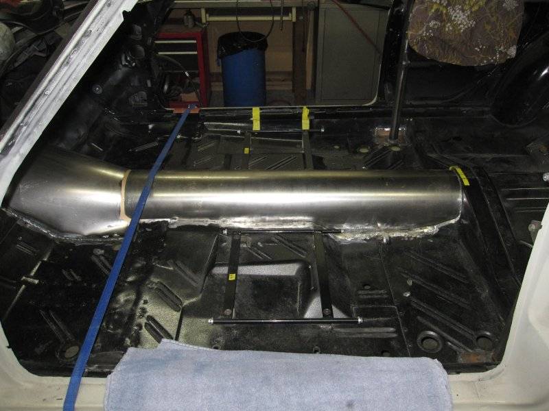

My tunnel replacement. You would not need the transmission (front) portion. I did, as I elected for maximum engine set back. I had a S/M shop roll a U shaped piece 9 1/4" diameter with "legs" long enough to extend past the lowest floor pan area and stitch welded the inside first followed by seal welding the bottom. 18 gauge metal.
Finished floor turned out nice.
Mike
My tunnel replacement. You would not need the transmission (front) portion. I did as I elected for maximum engine set back. I had a S/M shop roll a U shaped piece 9 1/4" diameter with "legs" long enough to extend past the lowest floor pan area and stitch welded the inside first followed by seal welding the bottom. 18 gauge metal.
Finished floor turned out nice.View attachment 1326729
Mike

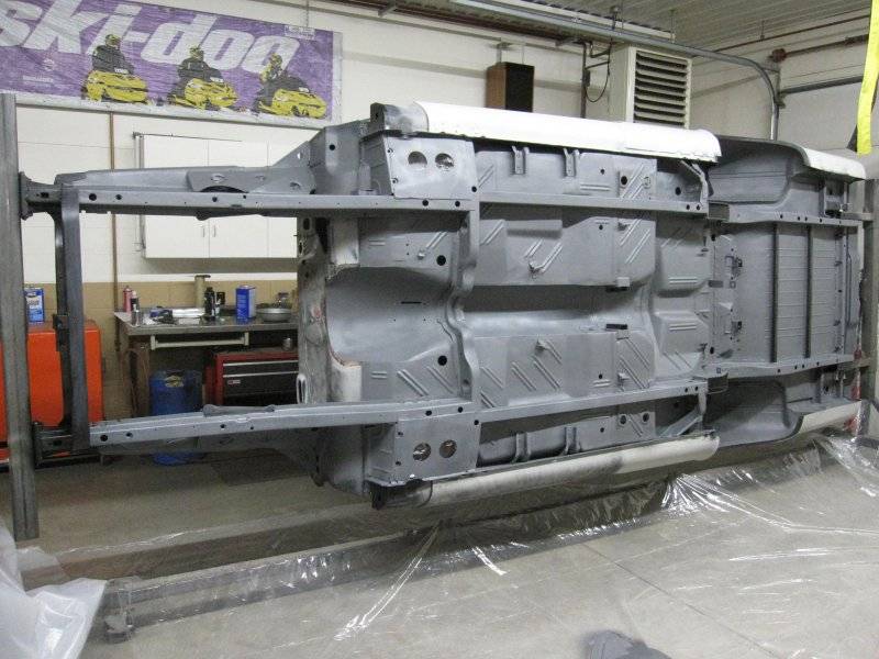

Looks nice. Wondering why you didn't install rear torque boxes since you did the fronts?
