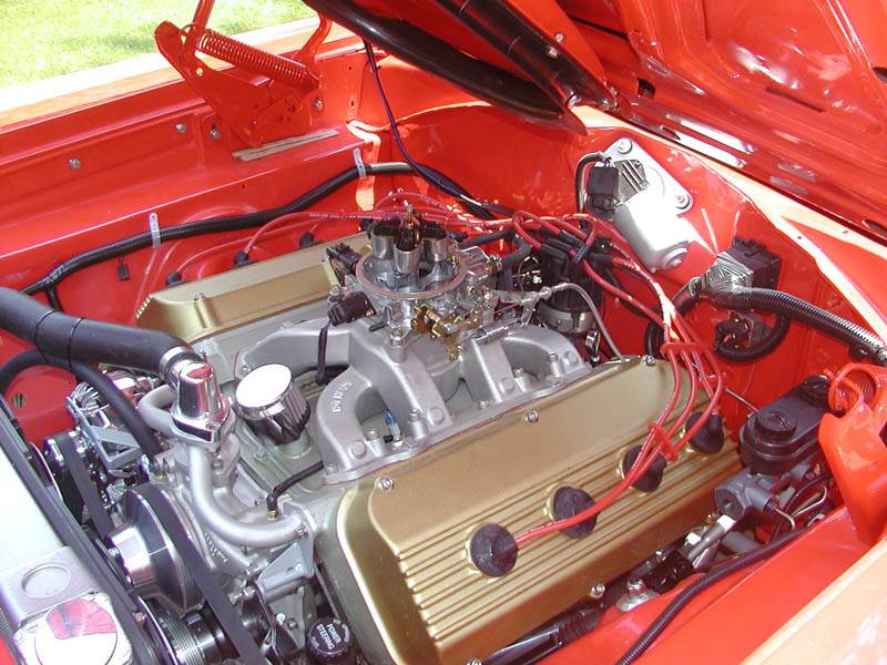

anyone every seen a 392 hemi gen 1 in a 65 B body. I’ve got a 65 Coronet and a 392 Hemi... wondering if it’s possible to do without too much cutting and modifying

A real 392 will work very nicely in a 65. I would do this instead of wasting time with anew Gen III so called hemi which doesn't have the cool factor like a real hemi does.

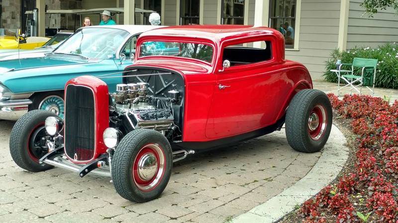

Its your car so do what you want.... however here's a few things to consider. First, building an early hemi is EXTREMELY expensive. Just a stock rebuild will easily cost double what a performance rebuild in a B or RB will cost. Second, in order to match the horsepower of an RB you'll need a fair amount of performance goodies which also aren't cheap. The logistics of installing any of the early Chrysler hemis isn't that tough but it is wide and heavy. A 392 will weigh over 700 lbs. without accessories so keep that in mind.
So, bottom line.. if your pocket book is deep enough and you want the cool factor then go for it. If you don't have enough cash for a performance build then the cool will be there but it will be a dog performance wise.
I've built and installed these in streetrods and my last one... with a stock rebuild was a little over $8000 and could easily be out run by just about any small block chebby. Ran 3 deuces with the outboard carbs blocked off. A real tri-power setup is expensive. If I had added another 3-4 grand in performance parts it would have been different but my pockets weren't that deep and I was just going for the cool factor. Below is a pic of my Deuce. Took 3 years to build, drove it for 4 years and sold it to a friend for a 5 figure check and the Corvette in my avatar.
Good luck either way.

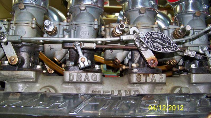

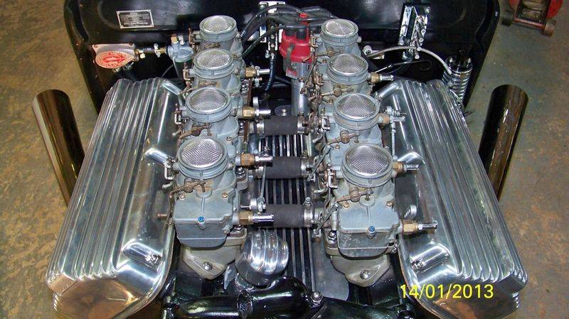

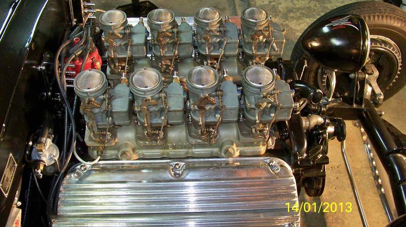

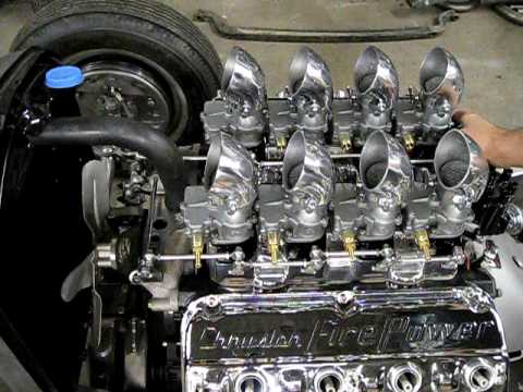

I love the old 392 and they are beautiful eye candy in the old street rods but like centerline said they are costly to build up ,I got a bunch of them and I want to build one up for my model A sedan delivery but it is a money pitt have been looking for a eight barrel manifold

quite easy especially if you get the Wil-Cap adapter to the 727 torqeflite, I dont see any cutting issues , I have seen this done 3-4 times, paint the engine orange half the people wont notice its a 392- even with the dist in back. in my opinion , the early hemi is a better choice than the late late hemis (gen3?) If I had it I'd do it and now you have given me idea's. now I'm excited- sure can't afford another426 hemi.
if the 727 is from an A block, even easier to adapt.

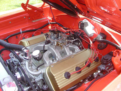

I just took this in on a trade. I really need to sell it, but I think I’ll hang on to it for awhile just to admire what’s under the hood.
