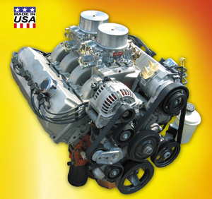

I seen a few write-ups on this setup and wanted to see what everyone thought of it, Gen III with carb setup, Indy has a mod man intake to setup dual carbs on the G3, nice looking setup, has a classic look and a big difference in price.

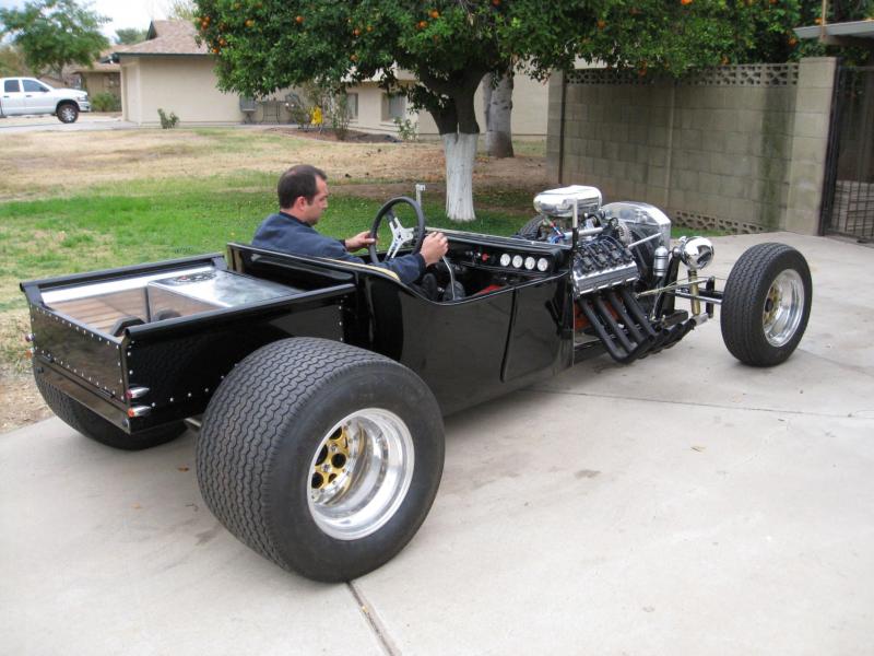

I built a hot rod with a 5.7 Hemi drive train and wiring harness out of a ram truck. I could not figure out how to make the electronics work. So I got a 750 carb ( free) and bought a Mopar manifold off E-Bay ($150) and a MSD Hemi-6 ignition box ($400). Got a used 727 ($200), a manual valve body ($250). The car weights 1850 Lbs and has 4.30 gears. This is the simplest way to go and cheap. Has zoomy headers which surprising are not very loud. Handles great and can smoke the tires at will.

Super Bee Ski, that's the setup I was referring to "Indy Hemi" 6.1 with dual carb setup, really like the look of it, very unique and they offer a few nice upgrades to include a 426 cu in. package with numbers in the 500 range.

Paid $1200 for the complete drive train and all the wiring harnes off a 70,000 mile 2004 ram. Sold than tran for $200 and all the original wiring harness for $100. I bought an electric fuel pump off Ebay for $40 (new). I didn't need a regulator or return line. Starts up every time. The motor is stock. The complete cost of parts to build the car was $9000. Fabricated most everything in my garage (frame, bed, suspension, cowl steering, pedals, fuel log, fuel tank, headers, etc). Bought the fiberglass body. It has sprint car wheels, sprint car lightweight front axle (aluminum spindles with titanuim snouts, magnesium hubs, wilwood sprint car brakes). Front suspension is sprint car torsion bars, the rear is 4 link with dirt late model coil overs.

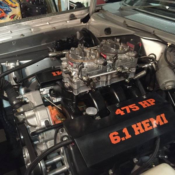

I have been thinking about buying the modman intake, running dual throttle bodies off of 2 older 360's and drilling the manifold for the fuel injectors. This way I could run a dual 4 barrel style air cleaner and fool people with the exception of the visible fuel rails.
Just a thought but would also require me to go to a different fuel injection setup to get rid of the required drive by wire. But I do like mine being fuel injected, better fuel economy and will start no matter what.
gccuda,
Where did you pickup the 6.1? What do you plan on putting it in? And you will be doing a dual carb setup with the modman intake?
