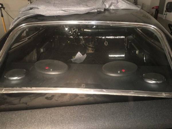

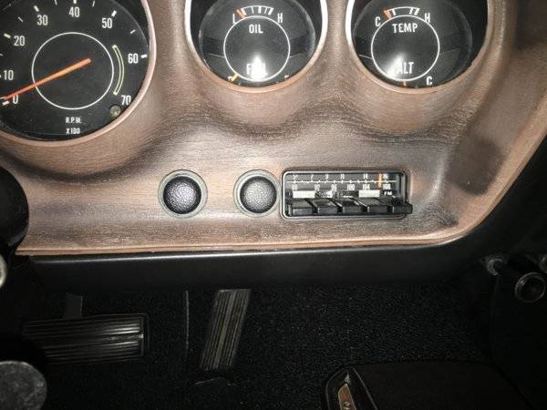

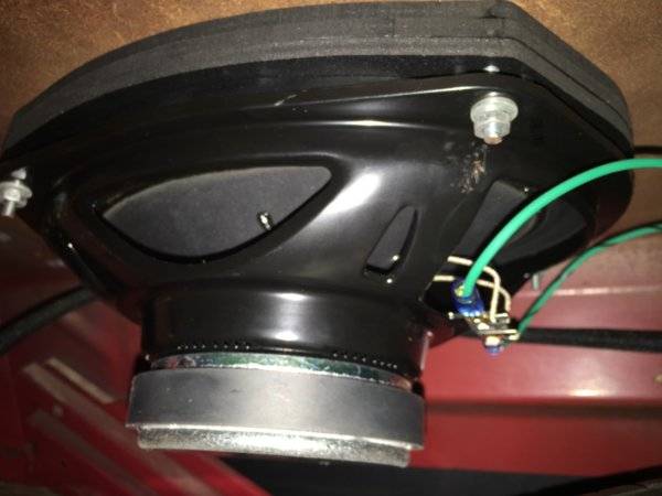

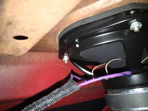

Did a sound upgrade to my 73 rr recently. As stated, driver side opening is not for a 6x9 and you will have to sacrifice some sheet metal to get a correct fit for a 6x9. The passenger side opening will work out ok. Installed my speakers from underneath (trunk access) and used spacers to get them sitting low enough in the openings for there not to be interference from the parcel shelf. Spacers of various thickness are available from places like Amazon and ebay. I placed two Pioneer 3-ways in the rear and two of the 3.5 inch Pioneers into the front speaker hole by utilizing an adapter plate, that gave 4 channels. Speakers are all out of sight, so it gives the look of being "original-ish." I sent off the AM/FM radio to have a modern conversion done to its internals, so it puts out some wattage and sounds pretty good now.
3A1A03F1-FA19-4275-A7C2-DA68A2686606.jpeg BCAF4D7F-CC8F-4A02-9F10-72EBD53E24A8.jpeg C27DC761-219B-4367-B750-FC11D3369AB7.jpeg

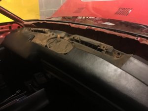

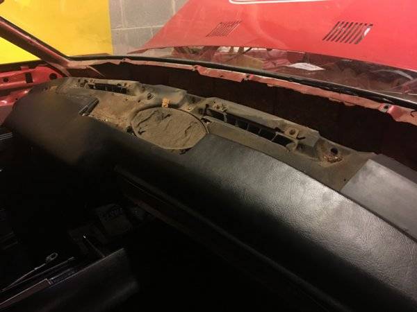

Could u get the front speakers installed with the dash in?
Well I very much doubt it. I had the dash completely removed when I installed the adapter plate with the speakers in it. Think you could drop the steering column and remove the bolts/screws at the top of the dash then rotate it back enough to do the install. That way the dash doesn’t have to be completely removed but you still have enough room to drop the speakers in from the top. Here is a pic from when I removed my dash, it has two bolts at the bottom and you can pivot it on those bolts.
yes it can be installed. The front speaker fits from top on 3rd gens not from bottom. Is an unique speaker basket frame, not the same as earliers. just need to remove the top grill frame and voila.
3 phillips screws in front of dash pad, and 4 1/4" hex heads at sides of the windshield vents. That will expose the speaker with windshield in place and dash frame installed ( this grill needs to be removed anyway to drop the dash frame thought ! ). Once this grill is removed you'll have access to the speaker. Dash frame serves the bed for the speaker.
