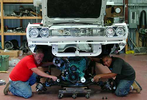

Put the rear end in first with wheels and tires. Now it can be moved around easier. Put the engine in the K-Frame
and lift up the front of the car and assemble it just like they did at the factory. You'll need a wooden cradle for the engine
and transmission so it will be at the right height so you can put in the four K-Frame bolts and the transmission
crossmember. You can lift the front of the car up with a 1" nylon sling and an engine hoist. and lower the car
down around the engine without scratching the paint in the engine bay.
Good advice about installing the wheels and tires, I didn't even think of that.
I grabbed these pic's off the Net, but they give you an idea about how you can go about the task!

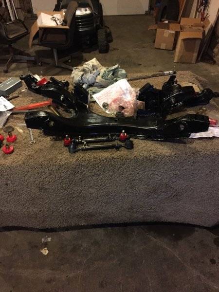

Unfortunately the engine is not yet assembled as we are still somewhat undecided on what direction to go with it, but that’s a whole other story....
Anyways here are some pics I took a couple weeks ago
