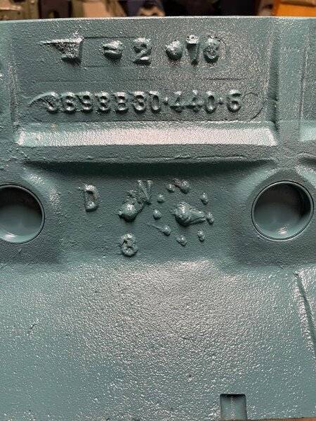

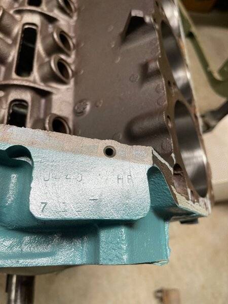

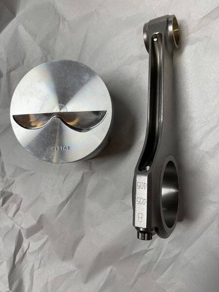

Here's the 440 I'm using for my Charger. This is a 7-2-73 casting with the ID boss stamped with J440 HP and below that is 7 12 2. Not sure what it came out of but the original rods were heavy duty and looked like 6 pack rods. It has 440-6 on the casting but don't know if this may have been a surplus that never got used in a 6 pack car. Been bored 30 over, balanced steel crank with Eagle rods and forged Wiseco pistons. Will be running 915 heads and plan on using a solid lift cam...just need to decide which cam will work for my needs.

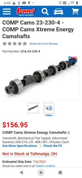

I'm running a 456 (400 based stroker) with this cam in it, I built the motor to be super street friendly yet have plenty of oomph, this cam worked beautifully. It has an advertised rpm range of 1,800-5,800 but it likes to be cranked up to 6,000. No complaints, has a health sounding idle and really pulls hard.
Over-camming is exactly what I'm trying to avoid. I went to one of the cam sites and did the ask the expert...filled out the form with my set-up and their recommendation to me seemed over cammed. The results were .519/.531 int./exh. advert. duration of 294/298, 240/244 @ .050 lift. That seems a little much for my needs unless I'm just missing the big picture of the whole package as one unit. Any advice is greatly appreciated.
What's the LSA on this cam?

* an actual Piston TDC Measurement/CC Volume installed in the Block, because WISECO Pistons are typically built generously DOWN from advertised at TDC ..... and it is Not uncommon to install WISECO's thinking they should be .010" or .020" down and find them closer to .030" or .040" down
Are they indeed WISECO's ? or Pro Tru Pistons made by wiseco ?

The '6' in the 440-6 is merely the tooling revision number, for example I have one marked 440-2 and another marked 440-3. 440 engines of those years were very widely used in trucks and RVs and many got the heavier '6-pack' rods and a forged crankshaft. With the 'HP' stamp it should have started life in something 'cool' but as Challenger340 pointed out all blocks were the same, the 'HP' meant it would have gotten the 'performance' version of any internal parts for that model year (camshaft etc).

the -6... -8 or -4 are indeed as stated just farum/tooling revision numbers as to how many individual cylinder casings have been replaced within the TWO 4-Cylinder casing halves that were used to cast that particular block.
Your Block is a -6.... meaning minus the "2" case halves used indicates that within your Block "4" individual Cylinder casings were replaced over time on those two halves utilized.
A -7 would be minus "2" indicated revised case halves used with "3" replaced
and so on
That's ALL the 'dash whatever' numbers after the cubic inch designation mean
