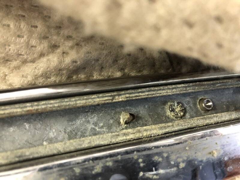

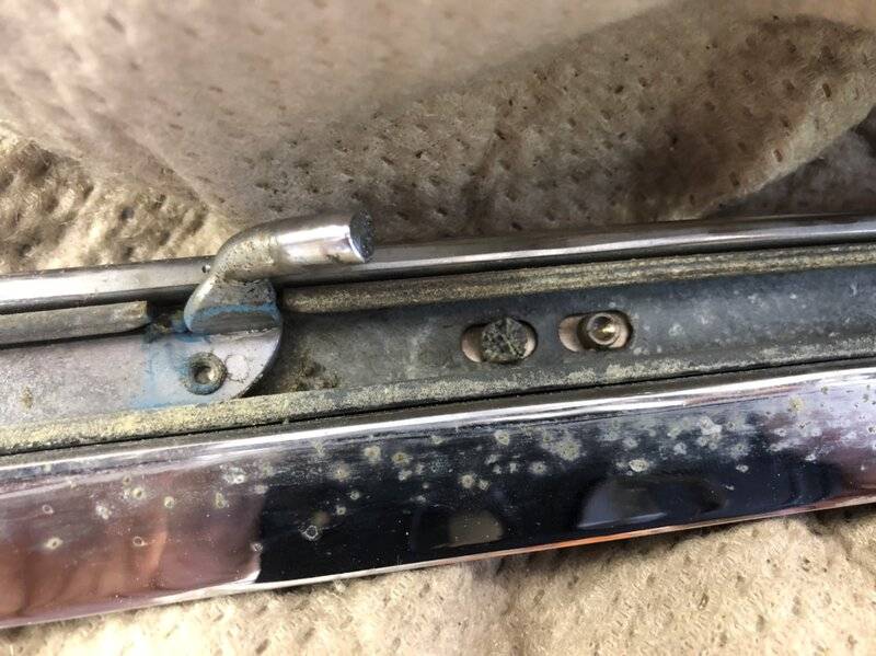

So I want to get the pitted vent window frames repaired and chromed. The framework is peened to the pot metal chromed piece. Do I just grind down the peened tabs to remove the framework? Can I just epoxy it back in place when chrome is done?

In my case you send it to the chromer and let them take it apart! That way they chrome the post and polish the SS.. I see your vent window pivot is snapped off.. that's not good! But yes you can use a dremel and round off the post that is preened to separate it.. the other is your spare for when you put it back together, but I caution peening it and if I could do it again I would have just bonded.

Pot metal is easily fractured and able to be ground off with a cut-off wheel. I have used a very narrow chisel also and knocked them off. Panel Bond to put them back together.
I took mine all apart and had the chromed. Pivot is just rivets, drill out and the. Rivet back. I took my time with the smashed pins and worked them back slowly. Gives you some meat to work with. Using epoxy to put them back together is a good idea too. My build thread has some details on the process.
