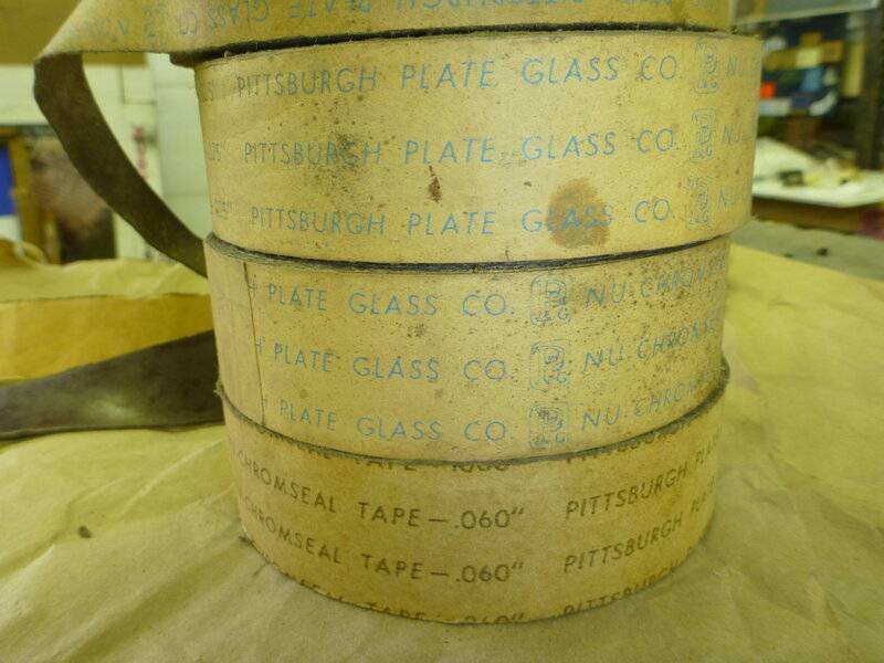

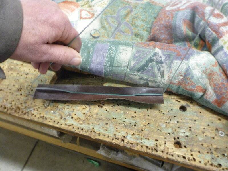

Glass setting tape. .032 works good for the stainless strip. Drop by any glass shop that does mirrors or cabinet sliding glass.
