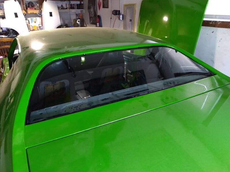

Glass day!!!
JG71B
9:33 AM
Mar 26, 2017
762
713
NE OH
Almost there!
Nice. Need a rear windshield myself. Where did you get yours?
Looking good! All new glass or just really clean?
If thats urathane your going to want to fit your trim because theres no moving it after it dries , factory used 5/16 butyl tape
And that's why this is the third windshield in this cars lifetime! Guy has been doing this for 35 years on his own and does all my body guys restos and knows exactly what we want considering most of them are Mopars
didn't mean to offend you , you've got a nice car you obviously have a lot of time and work in, mine had the back window urathaned in and the trim wouldn't clip in a few spots and i had to cut it out and start over , that stuff is a lot harder to cut out I thought I was going to break it, whoever did mine obviously never did one before, cant wait to see your car finished
Not at all sir! Not at all. Before he started he asked if I wanted to put the Clips in before or after any of us be plenty of room and didn't leave me a bunch of valleys and peaks to have to deal with when the trim goes on. Lol trust me I've seen so silly **** with that stuff thru the years!
