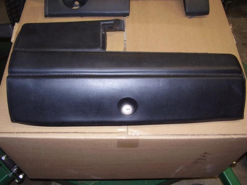

The rally dash glove box door used on Charger, Super Bee & Coronet R/T has a impressed area running the length of the door (see photo). The standard dash door ( Coronet, belvedere, Satellite, Road Runner etc.) is smooth.
