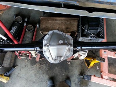

Well finally got everything figured out went with the 4.56 gears had to be for the series 5 locker I got. Finished the set up today juat waiting now to buy the axles then time to install and fire up this engine :headbang:
