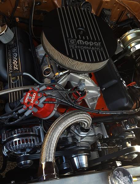

I used the SD kit with A/C, I'm not sure what the pricing is now but at the time they were quite a bit cheaper. Nice kit that locates things nicely and uses a single belt with a tensioner. Can't see much in the picture but I did a thread on the installation that shows it all...True Serpentine belt install on a BB mopar .
Wow I didn’t read the whole thread but the pics didn’t do it justice for how tight you were dealing with. It looks great but even just looking at it I can feel my knuckles bleeding
my guess, just looking at their design, the pulley is moved really far forward away from the body of the pump, and the extra torque on the bearings probably wears the bearings prematurely. on our kit we designed it so everything works in the same plane.

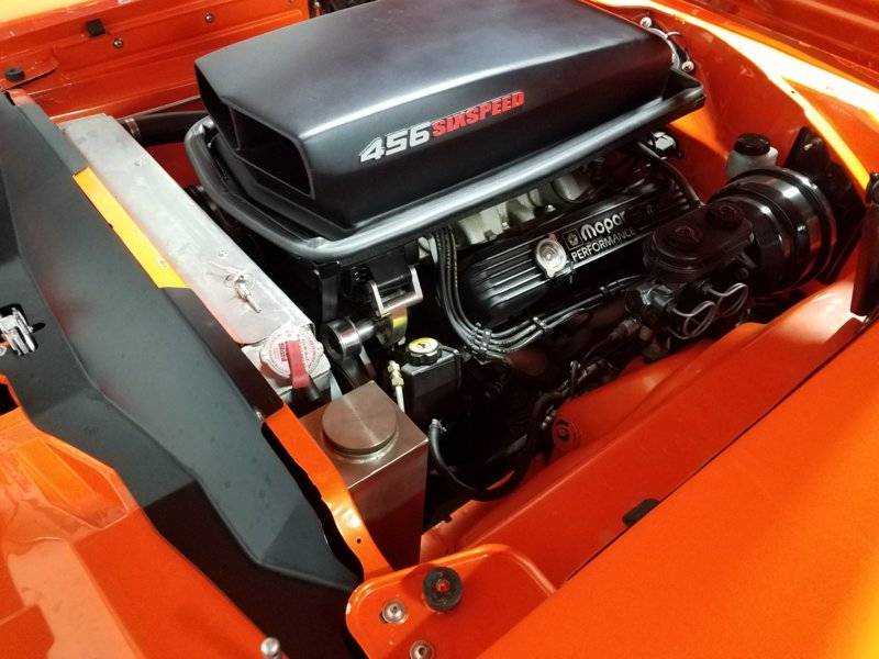

On my Tru-Track, it uses a power steering pump that uses a remote reservoir which add another $150 for the reservoir, and $200 for the hose and fittings kit. I noticed the fluid was getting hot, so I added a cooler too (more $$). Overall the system is nice, but the remote reservoir setup has been the biggest pain to setup and get to seal. The reservoir fittings are like aluminum bulkhead fittings sealed with a teflon washer, and it is hard to keep them tight and from leaking. I plan to remove reservoir and tig weld the fittings to keep them from leaking.
