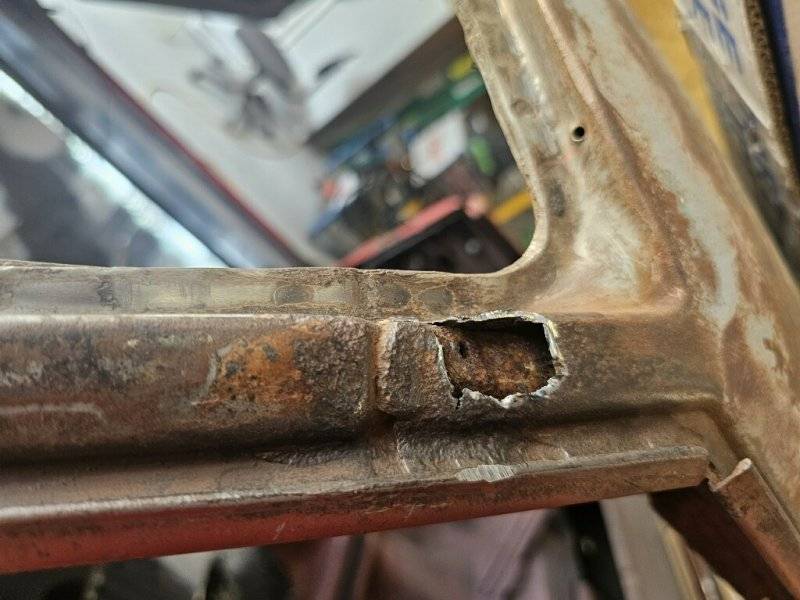

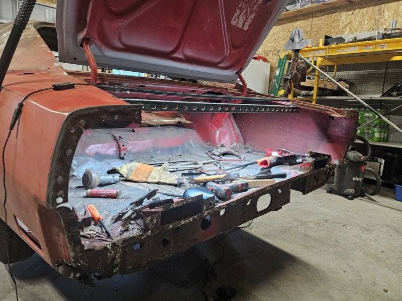

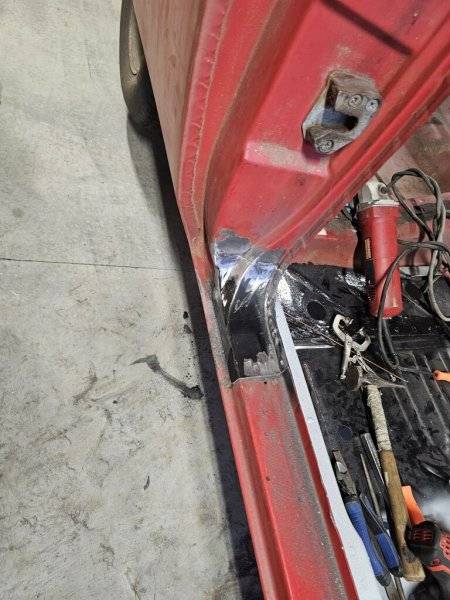

My 70 charger was solid and it still needed metal work done. You wont know till you get into it.

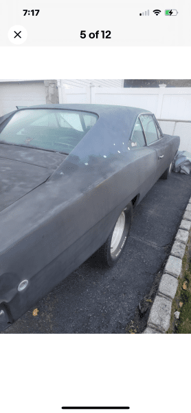

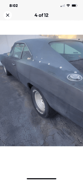

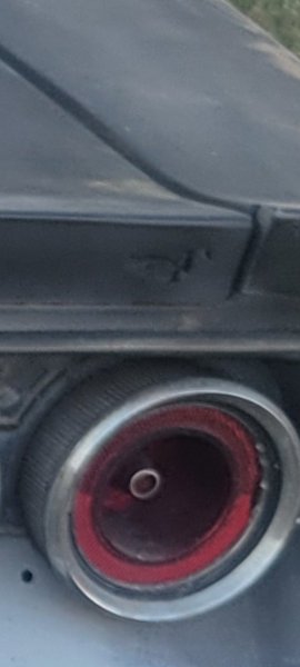

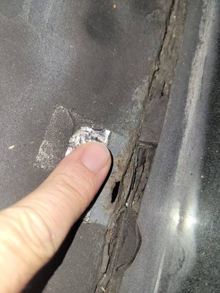

Always issues on the bottom of the back window on Chargers. Usually under the gasket. Corners too.

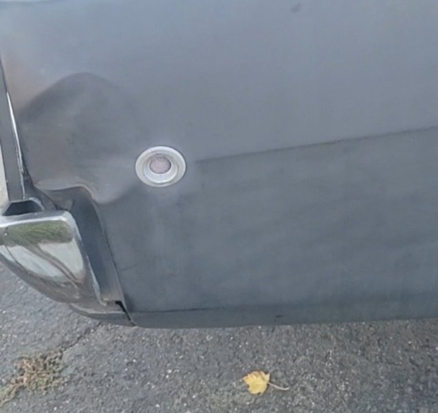

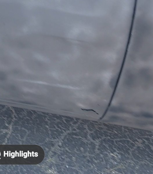

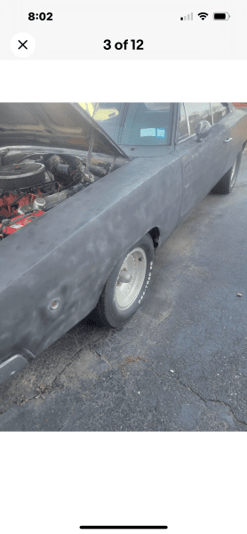

As others have stated, you don't know the quality of the seller's work. If the floor pans and quarters have been replaced, what's his definition of quarters being replaced; full quarters or skins up to the upper body line? A common place for rot is the rear window channel, which affects the Dutchman panel & the inner portions of the rear quarters. It's got trunklid rot, door rot & I imagine that it's also got to have fender rot and why is the car shown with half the trim on and half of it off? I'd certainly want to see the interior, fender tag, under the hood and underside of the car before I were to take a long trek to see it.
To me, it looks like a car that he's fixing up while still driving it. Did he send you any more pictures other than these few crappy vertical cell phone pictures? Good quality pictures showing more of the car and his repair skills are a must.
