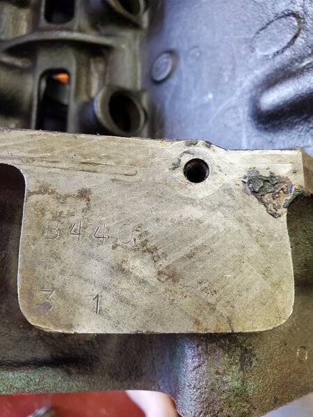

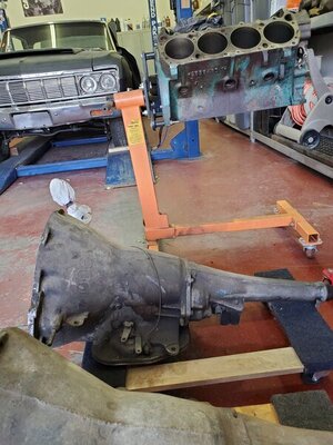

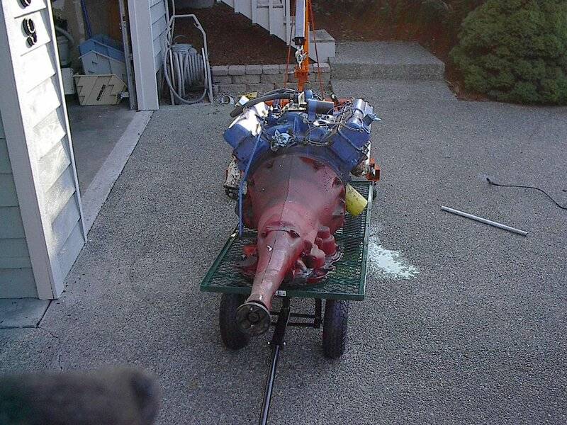

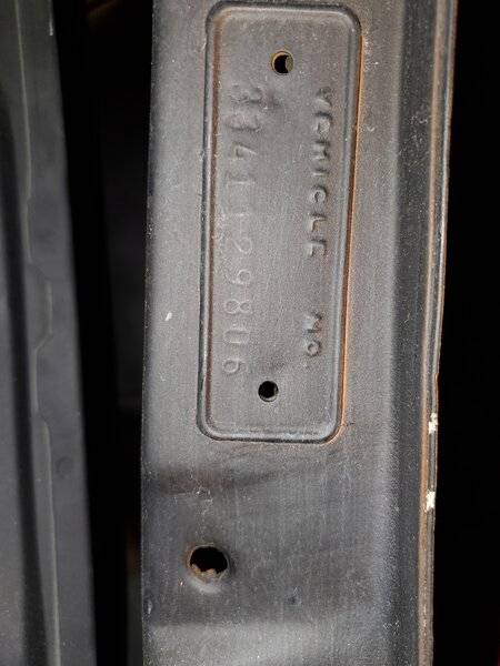

Here's the story....I was living in Washington and in the process of restoring my '64 Fury in 2005 when I got recruited into my present job in Wyoming. Life then took over and the project has languished. The '64 started life as a push button auto with a 318 poly. I bought a console and cables and converted to a floor shift. I also got rid of the bench seat and bought some buckets out of a '65 Coronet. I came across the B440 and it's attached transmission through a thrifty nickel ad. The owner said the engine ran and the transmission worked and I asked around and felt that the engine would mate to the original cable shifted transmission. The company moved my household but I had to move my project myself. To get it on and off the trailer.I commenced to installing the new to me 440 and the original cable shift transmission. I then sat on a milk carton and used the emergency brake to stop and a gas can with rubber hose for the fuel tank and a piece of twine for the throttle. The car was pretty gutted. I got the car to Wyoming, parked it in my rental house garage for a year and drove it to its new home where I removed the drive train, such as it was. Here are pictures oh the B440 block and the transmission it was hooked to. Here is the cable shift original transmission from the '64. The poly is long gone. Take a look.
20200615_124604_resized.jpg 20200615_124634_resized.jpg 20200615_124701_resized.jpg 20200615_124712_resized.jpg 20200615_124724_resized.jpg 20200615_124731_resized.jpg 20200615_124742_resized.jpg 20200615_124749_resized.jpg

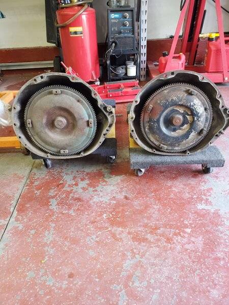

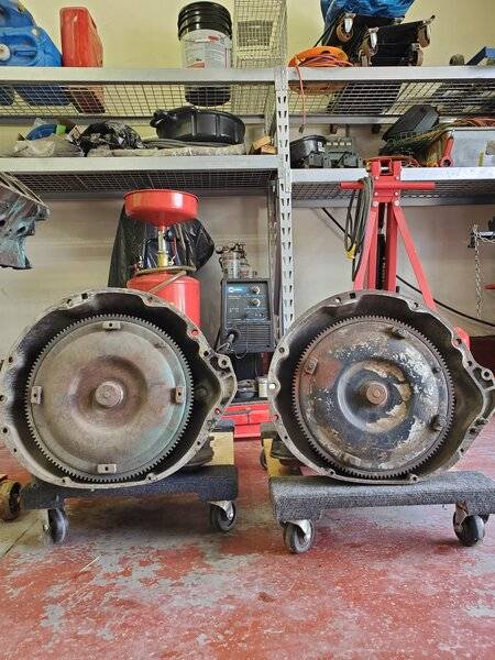

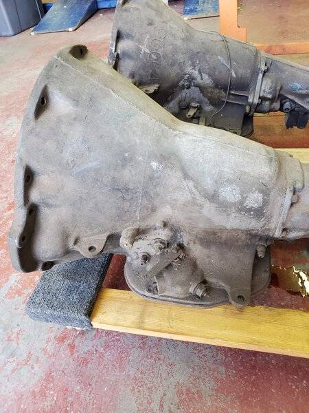

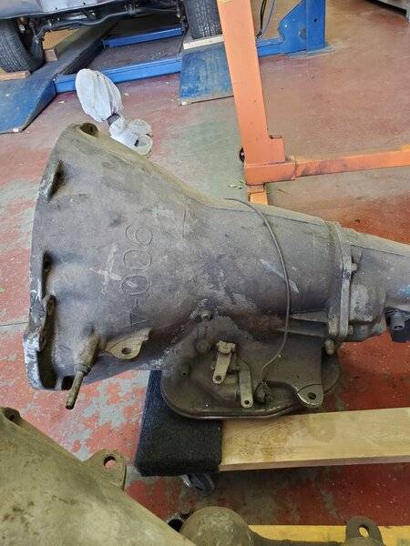

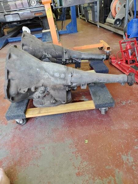

Newer trans on the left, pushbutton trans on the right. So it must have been an original Big Block car or someone changed it to a Big Block trans.

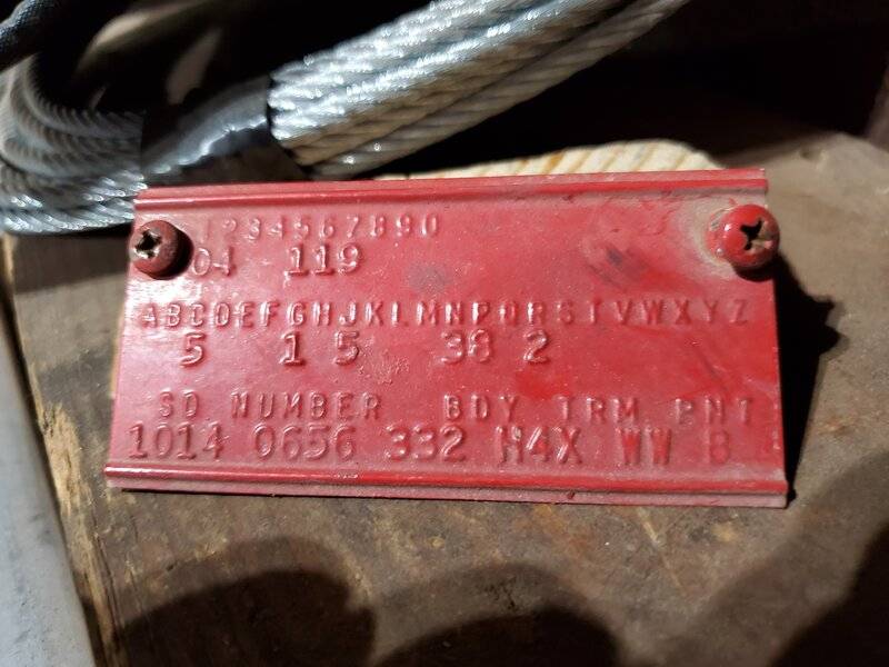

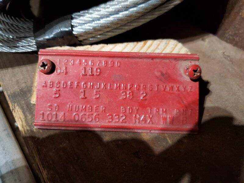

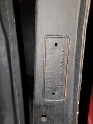

Give us a pic of the fender tag and first four digits on the vin.
I don't see how a 318 poly was ever associated with either of those transmissions.

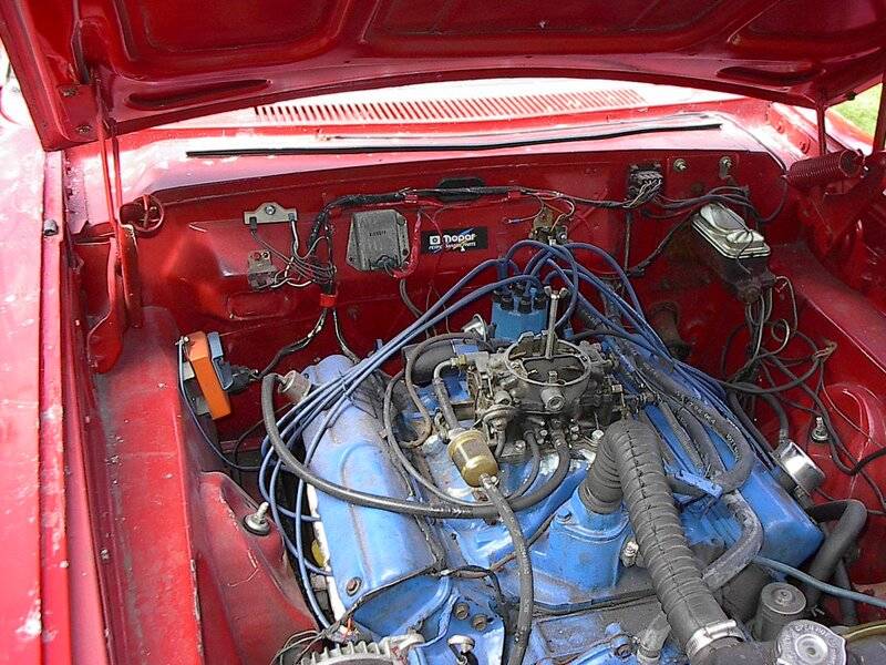

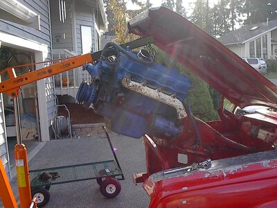

Poly 318 for sure. I have pictures when I was removing it prior to resto. Still have the cast iron 4bbl intake off of it. Weird valve covers, distributor straigjt up in the back......I will post some pics soon.
In the 50 years I've been messing with Mopars, I've never seen a poly teen trans mate up with a B or an RB engine.....
I stand corrected. Just goes to show how our memories can be faulty. My wife reminded me that I had to go and acquire the transmission in the process of moving to accomplish the task of getting the car driveable. I went and got the transmission that originally went with the console shifter I had bought. I remember giving the small block cable torqueflite that was painted red to the neighbors dad....now. So everyone. You are all correct and I was wrong. Here are the promised pictures.
redstrip 015.jpg pumpkinpatch02 033a.jpg pumpkinpatch02 029a.jpg pumpkinpatch02 022a.jpg
