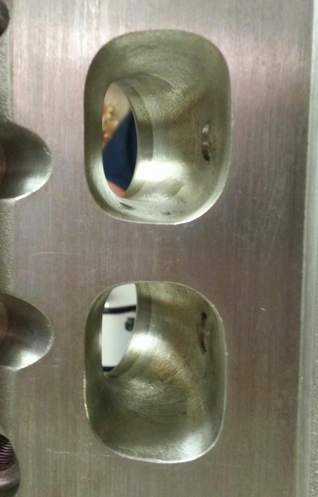

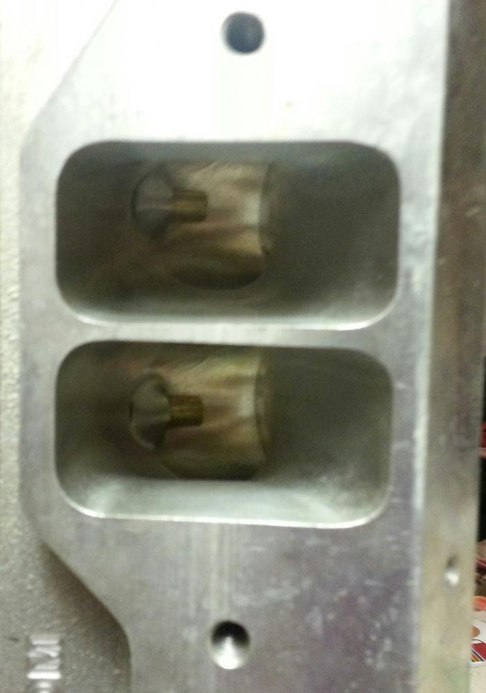

got my max wedge victors back after getting cnc ported

Now I just hope the pic load they look awesome.

Thanks everyone. Cncport.com did it they used mine for the program. Awesome people especially Jason who I was dealing with.

Nope they aren't they are back east. Not sure what they are going to charge they hooked me up for just the labor cause they used mine for the program. But they cut them for 2.25" int. but retain the 1.81" ext. If I remember correctly with a 50degree angle on the seats they were flowing 360cfm and with a 45 they will flow way over 400cfm. I would have to find the flow numbers that they sent me.
They did a god job. Found the post where I put the numbers.
Intake-.500- 340cfm. .600- 366 .700-381
Exhaust -.500- 237 .600- 253 .700-265
Done with a 4" long pipe and the seats were 45 degree but if you go 50 degree numbers are well over 400 cfm

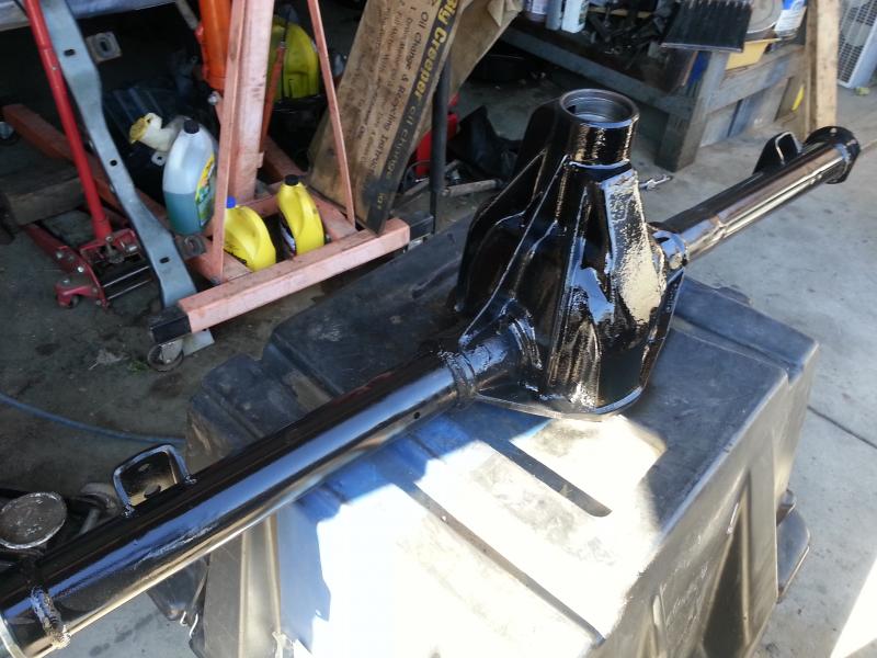

I also got my 60 back from the diff shop all welded up and ready got done painting it and waiting to install everything and order up the axles.
