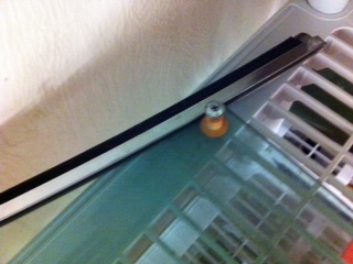

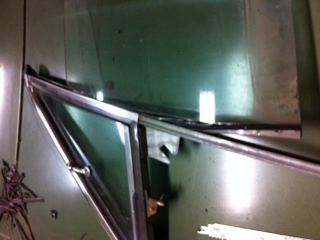

YY1 I have a mopar yard (wildcat auto) super close. would I be better off grabbing clean used clips off a 69 (and i would take a clip to compare from my car) vs. getting new from the sites daytona kid recom. two other questions for the guys that have played with this stuff before. I removed the guts from the door (glass, regulator, etc.) for the painter. I was careful but a few things got "tweaked" when taking apart. I have a loaded some pics to help describe what I am talkin about. the felt liner (where the window meets the wing window pillar) came apart on removal and the plastic window stop shattered when i raised it out of the door. really appreciate the help. Erik window stop.JPGdoor glass.JPG
Those felts can be bought at places like Molded Metro Parts, R/T Specialties or Megaparts. I believe Megaparts and R/T speciaties will have the window stops as well.

I'm guessing the front felt guide's are probably shot as well (ones that slide up/down on the backside of the vent window) Little harder to find, little more pricey.
R/T specialties usually has them, so does year one and you can still get them from chrysler:
Chrysler pt # 2932230
