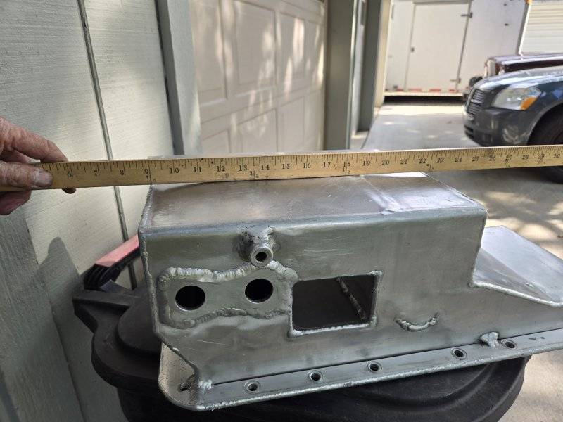

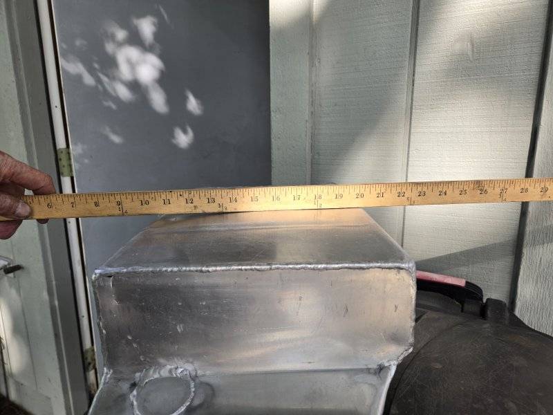

Pan is repaired. Should've took more pics. Sides were bowed. Inner trap door wall for the swinging baffle was bent. Windage screen was bent from the side bowing. Some creative work with a 4x4, 2x4 got most of it. The tough part was under the tie rod tube and the front baffle which is welded in. Used a 1"x 4" block of aluminum with a cold chisel. The point of the chisel could be placed at an angle on the aluminum block. You could hit it hard and even though it was at a angle it dug in and didn't slip. Welded up 3 cracks. After a air check with soapy water found 2 pin holes in previous repairs. Ready to go together.
Doug

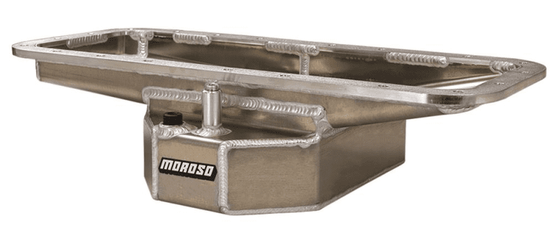

might be worth looking into 1 of these oil pans from moroso, same capacity with trap doors except 1 1/2 " higher..and dont forget the hockey pucks..
Moroso Street/Strip Oil Pans 20763​
It's odd how much the Moroso pan looks like the Milodon pan.
Mike
Yep Except it is differant in that on the passenger side the kickout is narrowed on the end to fit a 1963 plymouth crossmember after trimming away the lip Only with room to spare, they put some thought into this 1....so with the later crossmember installed on his car No problem fitting it.
