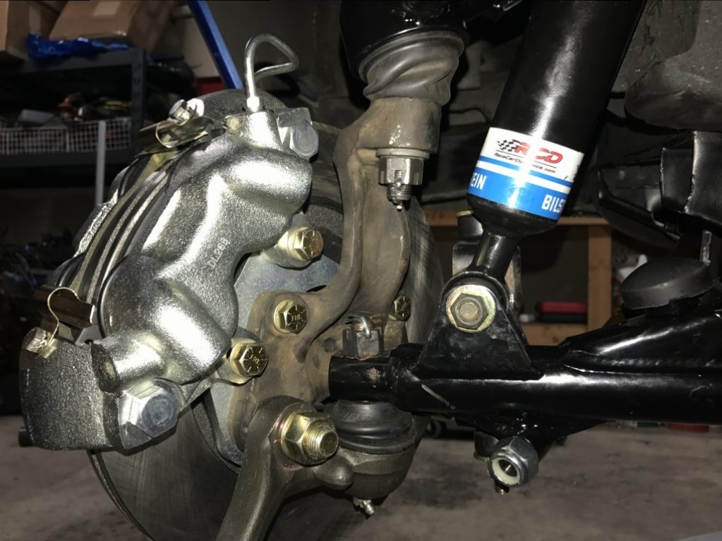

This kit is "made" to mount on the front of the rotor. I wanted the extra room for a sway bar mounted to the shock mount so I mounted mine on the rear of the rotor. First, you can easily mount these on the rear. Second, I'm glad I switched them because it looks like the calipers would have hit the sway bar mount.

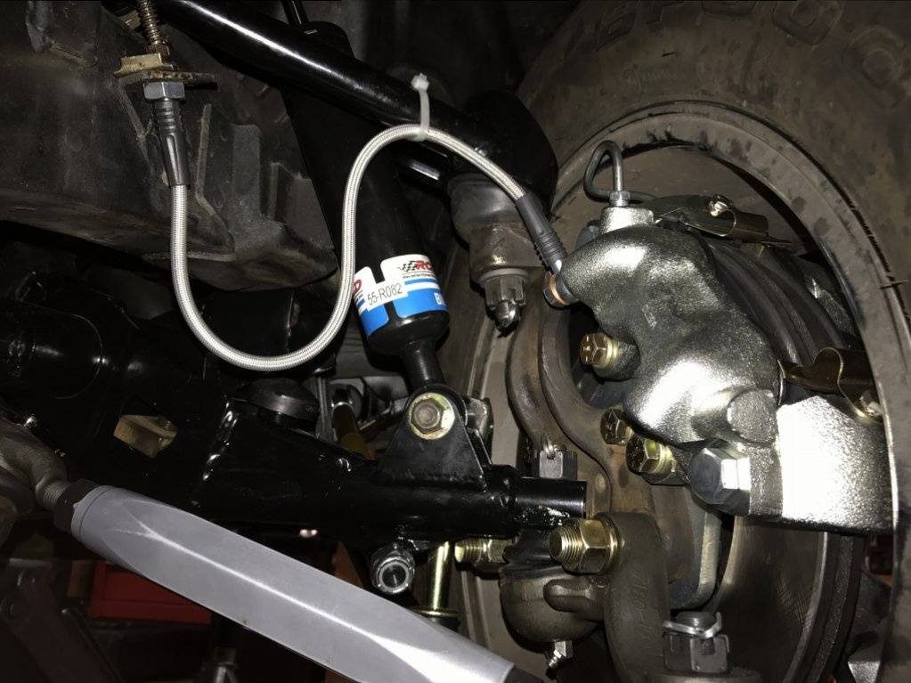

However, the kit includes lines made for front installation, as the brake line input would be facing rearward and would be located forward of the shock and would create a mostly straight shot to the stock brake hard line. Mounting on the rear points the brake line input toward the front and moves it reward of the shock. This means the line needs to take a 90 degree turn right out of the caliper. The included lines can be used, they just point forward then loop back toward the hard line. This causes some rubbing issues I am still figuring out. However, this is my doing and not the kits so I didn't take this into account. I will more than likely get some custom braided lines made up by a local hydraulics shop.

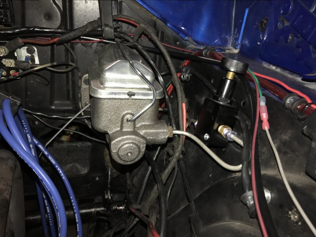

As for the rest of the install, I have never installed disk brakes before and this was easy for me. The hardest part was making the brake line run for my proportioning valve. The kit included lines to mount the valve just behind the stock brass block. I installed the valve up next to the MC so I could easily adjust the knob.
The MC easily installed into the stock location. You still need to be able to get to the backside nuts to tighten it up.

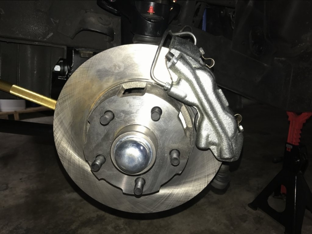

Why did I mark it down to an 8 then back to a 10? The kit includes a spacer that sits on the inside part of the spindle and pushes the rotor assembly into the correct location so it will lock down correctly as well as not rub on anything. The wrong spacer was sent with the kit. GPS keeps all the parts on the shelf and pulls them when they build an order. The spacers were labeled wrong and thus, I got them. More on this in the "Service" section but once I got the correct spacers everything went smoothly. I have included a picture of the spacers below. The thick one is the correct one.
Service: 11/10
This is where GPS really shines. The wrong spindle spacers didn't push the rotor assembly out far enough and thus the outer bearing nut would bottom out on the spindle threads before actually making contact with the washer/bearing. I called up GPS and spoke with Greg. He basically dropped everything to help me figure out what was going on. He even offered to FaceTime with me via his personal iPhone so I could show him the issue and all the parts. Greg finally figured out it that the wrong spacer had been sent with the kit. He sent out two correct spacers via 2nd day at no charge.
Service: 11/10
