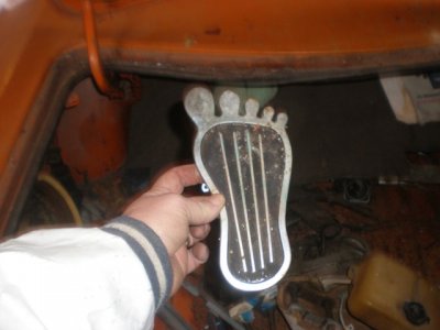

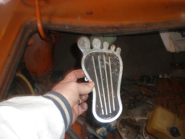

Thanks for the tips, guys! I found a steering wheel pulling kit locally - cheap, too! -and will update soon.
As to the gas pedal - I recoiled in horror when I first saw it, but my wife cracked up when she saw it, and said it just HAD to stay in the car. I have to admit...it's growing on me.
Gawd, I think I might need help! :eek:
