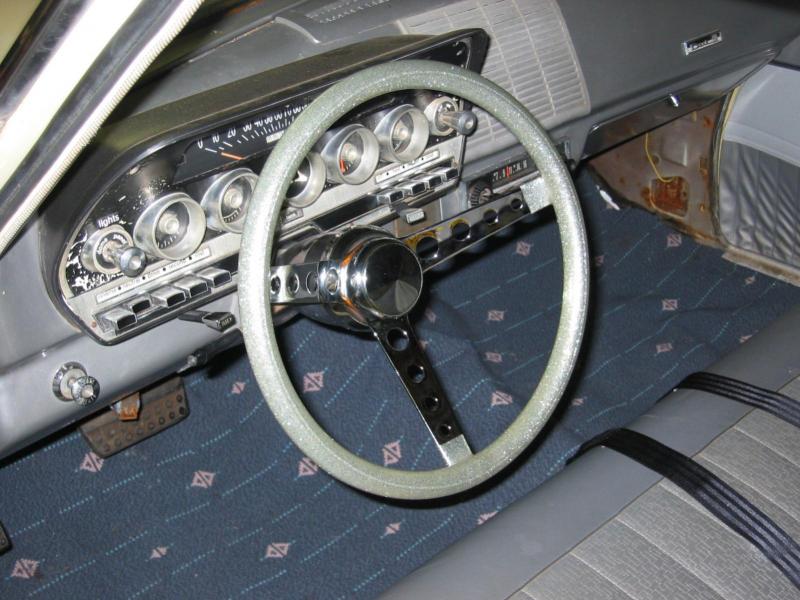

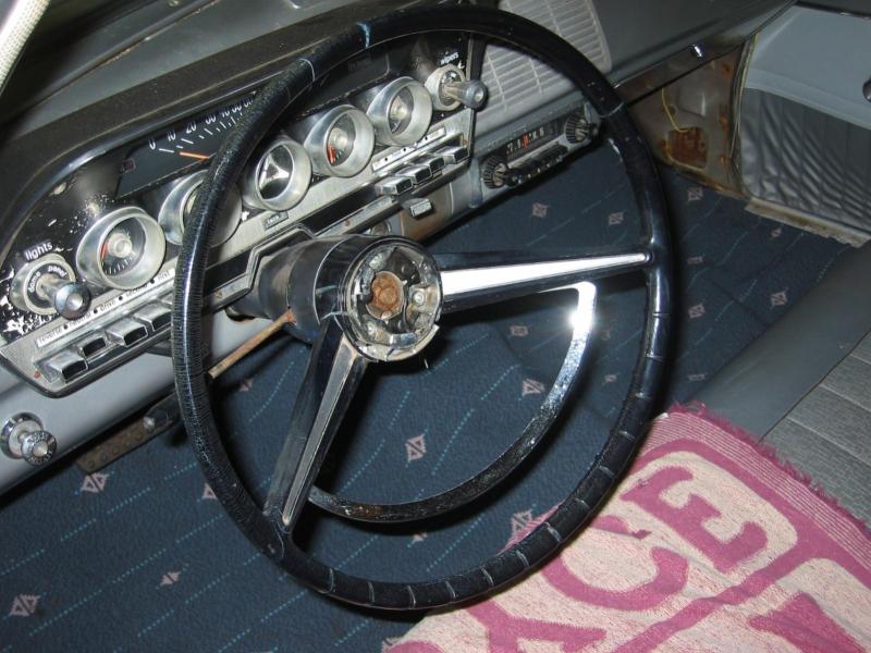

#4310 worked for my '62 and a Mooneyes wheel.... Gave me a lot more leg room:
Before:
