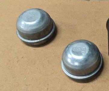

Original Chrysler 3580894 caps have "894" stamped on them:

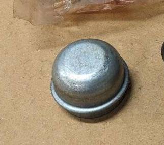

Original Chrysler 1613416 caps are plain:

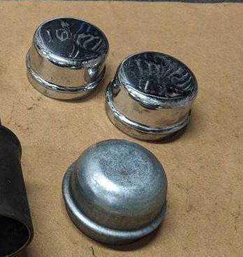

Some after market caps, such as the chrome caps in the following image are shorter and can interfere with the spindle tip:
I think so. The cap bottoms out on the tip. I can tap around the flange of the cap, get it flushed up on the rotor on one side, tap the opposing side down and it just rocks over the tip giving me gaposis on the opposing side. Just had a thought and I'll need to find them to verify, but the caps supplied with the package may not be as deep as the stockers. Need to find my pair for the 65, stock 73- units, to verify.
