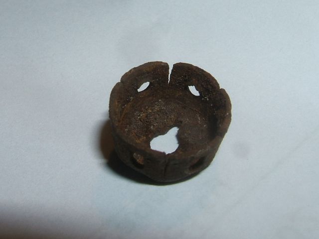

Hey guys what have you done or what would you suggest ,? We are fitting my grill back in and a couple screw holes are slightly stripped ... do i dare just put some type super glue on threads and call it good ? they do grab a little ....... Im scared if I put next size bigger screw in it may split plastic
Also Im looking for the bell nuts that hold hood inserts on, anyone have a set or a web address to where I can buy them ?
Or does any one have a picture they cold post of the bell nuts ? mainly the end ones

I bought some from R\T specialties a couples of years ago but they are pricey...
this is what you need
4 of each
what part of the grille is stripped?
some of it is screwed into plastic pieces that are on the grille brackets
and the center grille should have 4 metal inserts
at the end of each screw hole.
they are often missing and hard to find.
the often missing center and lower grille insert

OOOHHHH YAAA !!!!!!! you guys found them!!!! yesssssssssssss !!!!! thank you thank thank you !!!!! all of you rock !!!!!!!!
Hope you all have a great Mopar Day
Rog
would these bell nutes work on a superbee hood insert as well ?
Also have them at Wilson Products (?) too. Either way, they're $20 each
