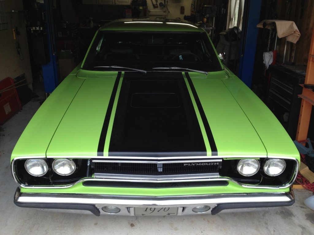

As far as my grille is concerned: I painted mine with silver and flat black (no fancy high dollar paints). Yes, I know, it is not correct, but I was running out of time before I left on my drive across country. My grille is not perfect, so I have to go back and improve it some time in the near future. I must say, through, even through it is too dark I like it! I will make it more correct soon...
This isn't a great picture, and obviously the car wasn't done, but it shows the contrast.

Light argent silver and matte black are the correct colors for a 70' RR grille and h/l bezels. Don't forget to pull out the stainless trim and fix/polish those and your grille will be bitchin'!
