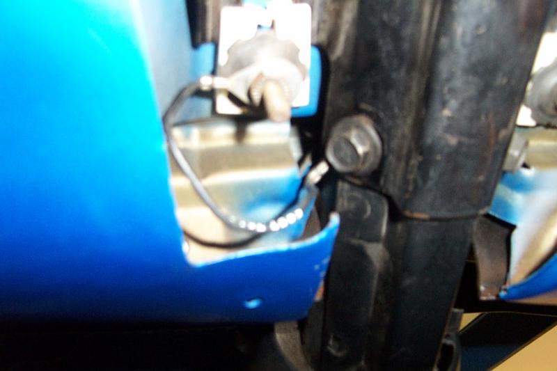

It is a jumper that provides a ground path around the white square plastic mounting blocks. One ring terminal goes to one of the mounting studs that goes through the white block. Other ring terminal goes to one of the bolts that holds the mounting plate to the column.
Found a pic. This is on my 72 but is the same for most Mopars
