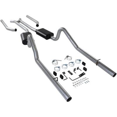

Noticed that summit racing has a exhaust kit for 70 roadrunner that has the H pipe between both sides of the exhaust. I have really only seen these on fords. Anybody know why? Is there an advantage in having the crossover better performance??

An exhaust crossover balances the pressure differential between the two sides, and helps with exhaust tuning of the power band.
X2...what he said! a crossover pipe is kinda like an equalizer...balancing the pressure between the 2 pipes inside the exhaust. and it makes your pipes sound alot smoother also....not choppy!:book1:
I went with the H pipe. I don't care if the X pipe gives you 3 more hp, and the H pipe gives you 3 more foot pounds. I had an X pipe once. It gave the car a different kind of sound. But the reason I ditched it was because I felt it was poorly designed once I got a real motor in the car. The shop took two U shaped pieces, then cut the sides off and welded them together. So the 2.5" exhaust went from a total of 5" of total volume for flow down to like 3" at the X pipe. It didn't really matter at the time because I had a stock poly. So if you go with the X pipe, make sure that right where the X part is there is not going to be a restriction. If the X pipe literally looks like an X, then your cutting down your ability to flow exhaust gases in half right? Or am I missing something here? Regardless, I wanted my exhaust to have a natural sound so I went with an H pipe per Flowmaster's recommendation when I stepped up to 3".
