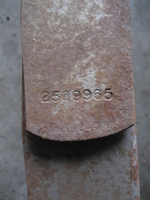

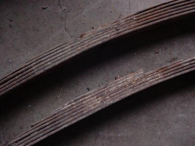

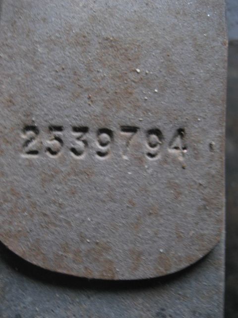

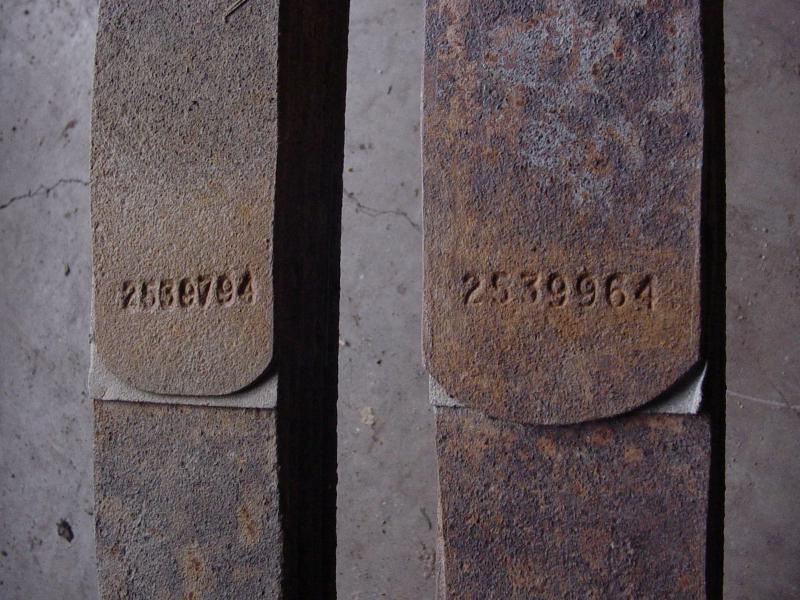

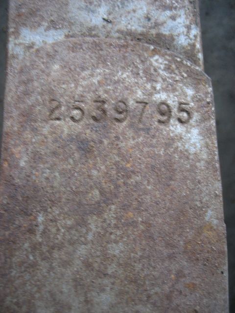

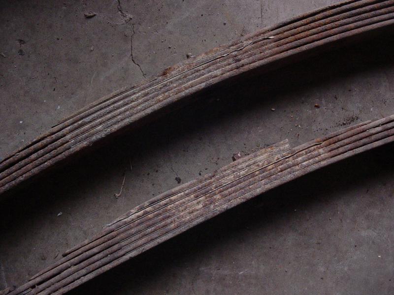

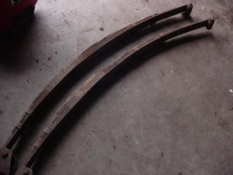

I have something similar to that. Pulled them from a 70 coronet r/t. Thought it was broke but could not find any evidence that proved otherwise.

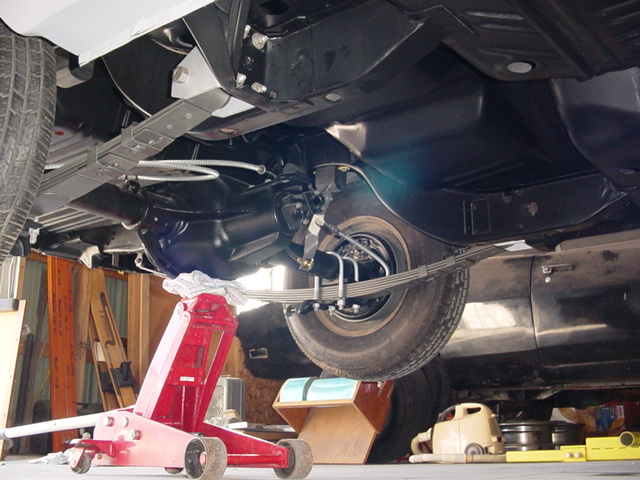

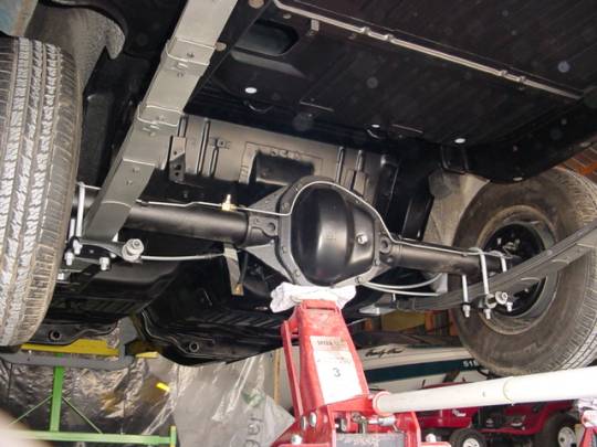

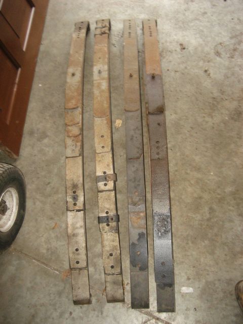

Correct me if i`m wrong here but if your main leaf is broke ,won`t the car collapse???? I was always under the impression that the main was solid, from front to back & has eyelets on either end for the bushings, so in this case, we`re dealing with a 1/2 spring toward the front, with an eyelet & bushing & then 1/2 spring toward the back, with an eyelet & a bushing. I always thought the 1/2`s were on the bottom for extra support, Like these pictured. I guess you learn something new every day!!

Thats the way they are... has to do with the progression rate of the spring would be my guess...
It's called a split leaf spring. For obvious reasons. The reason for it is to allow different rate for the front and rear segments. I'm not 100% sure Mopar ever used that system from the factory. I think it was added.
The factory did use 2 extra half leaves on the right side. But they were on the bottom of the stack. They figured out early on that without them, your hemi road runner would change lanes abruptly when romping on it teeheehee.
