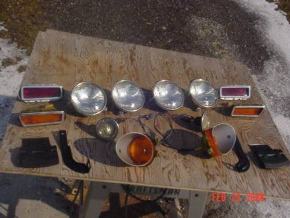

I sandblasted mine and painted them with dull aluminum. It's a little bright but dulls down. Looks pretty close. 3 years later they still look like new.
Doug

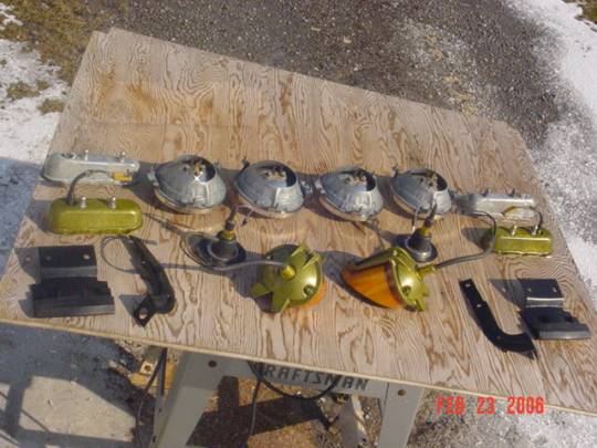

Like previously mentioned, galvanized steel. Mine were looking very sad & I used a small, fine sand, blaster & held it back a little farther then normal, so I wouldn`t remove the good galvanizing & once both sides were very lightly blasted, they looked really good & I just lightly clear coated them. They looked great & still do to this day.
