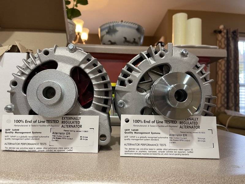

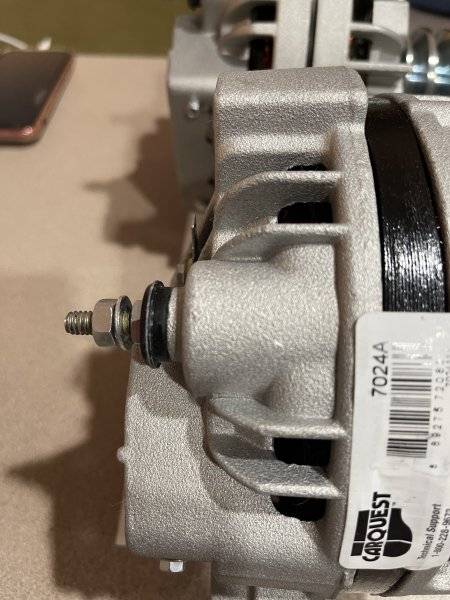

Thanks everyone. I’m going to start with a 70amp square back I purchased today and see what happens before I change the pull-up size. Still haven’t located a pulley. I have added a 10 gauge wire from alt to starter relay and kept the existing wire to the bulkhead connector. Can I ground either field terminal? Not sure about that part. And later will add the electronic voltage regulator if needed. Sounds cheap but kids still in college, on a budget for now. Thanks

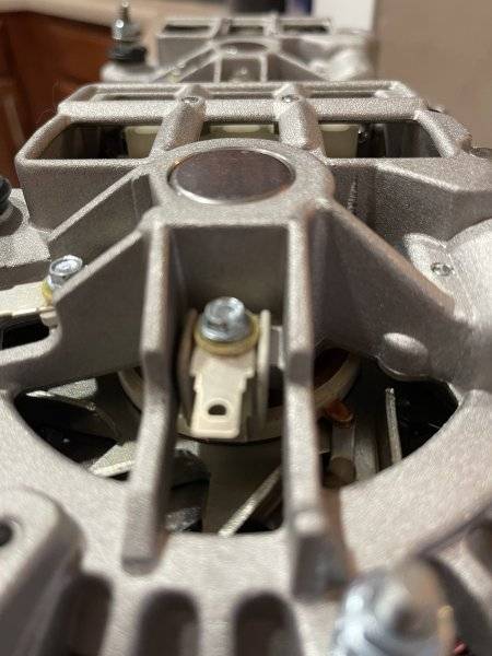

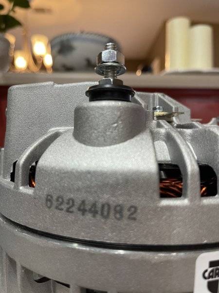

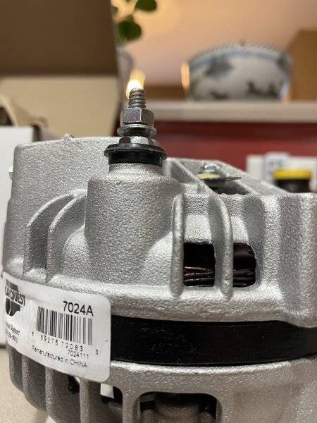

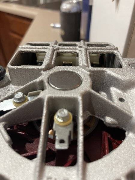

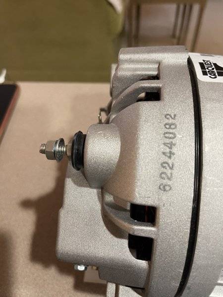

Never mind that last post. Tired of thinking about it and trying to rig up something that may or may not work. I grabbed a couple alts today for a 71 RR (if I remember right) These alternators are visually different and the higher amp one might not fit. So, I probably should just go with the power master round back and be done with it. And the VR too. Do you recommend summit or jegs? I attach some pics so you see what I mean and maybe will help someone else
