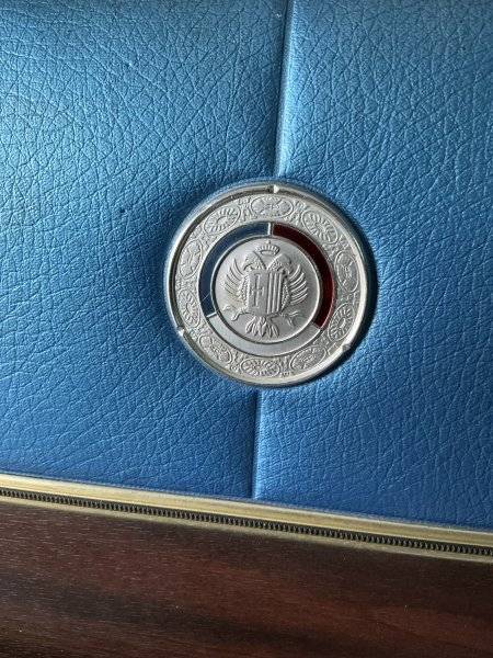

I have 74 Sebring Plus upper panels in my 7 RL21.
They actually say "Sebring Plus" on the emblem, which is the model of the car they came standard in.
It also says in the factory pic above "SSP door panel shown".
Also note the pic is specifically describing the seats.
That would suggest an RR with an upgraded interior would not have that exact panel.
Perhaps they made one without the SSP emblem for that purpose?
