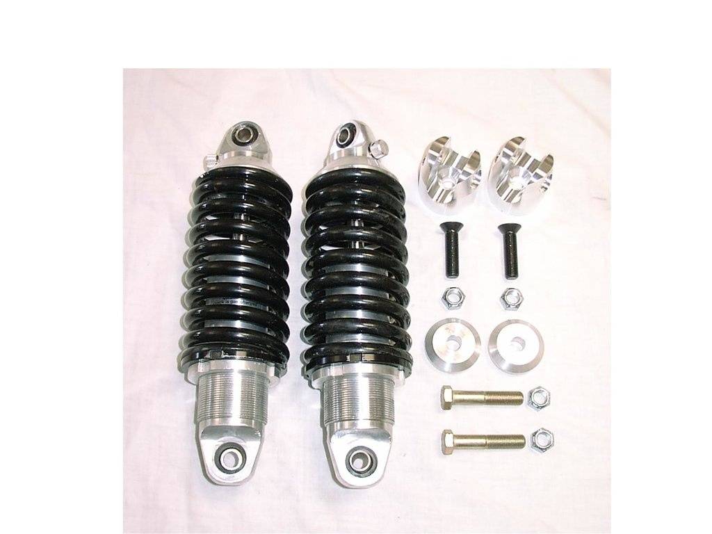

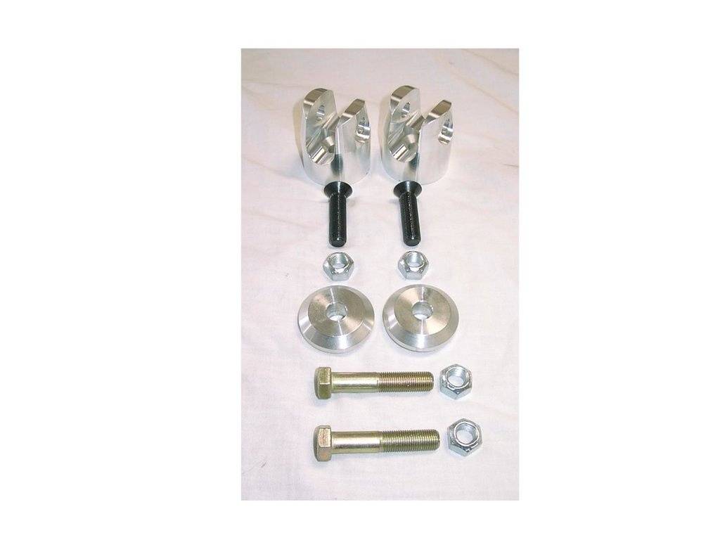

Magnumforce Racing $599
sell an adapter & Coil over kit, to put the coil-overs in the OE location
if you're not trying to autocross push it really hard
or really corner hard at track speeds, I've seen it used/done...
IIRC they sell the shock to coil over adapter separately too...
IMO the lower control arm is the more critical issue, if you went that route...

I have a 73 Charger, same front suspension, frame rails, firewall, inner fenders, etc. MagnumForce is the only company making coilover conversions for B bodies made after 1972. Someday I'll have one of their setups in my Charger.
It can be done, BUT the shock towers need to be beefed up a tad
the inner fenders weren't meant to support the full suspension weight
& the punishment
I'm not sure if you're aware, but 73 and up b bodies don't mount the shocks into the inner fender. Instead they're mounted in a bracket behind an inspection plate. The Magnumforce unit mounts their coilovers onto a bracket that bolts directly to the k frame and frame rails.
