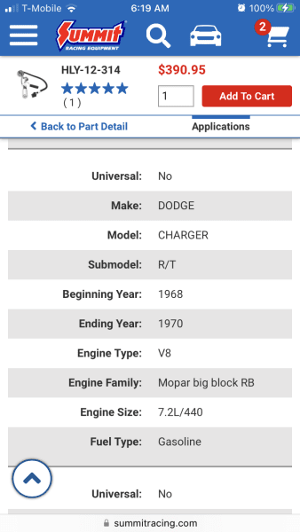

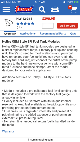

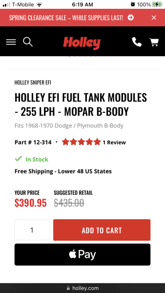

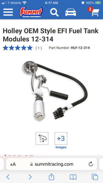

Has anyone tried this Holley b body gas tank fuel pump conversion?

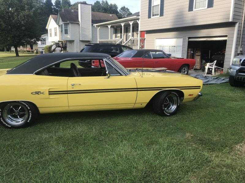

I installed one of these on a 70 GTX with a sniper setup. Went right in not an issue. Factory style tank. Not sure of brand on the tank.
How long have you had it installed now? Do you do a lot of street driving?
It was not my car but they guy JJ drives it every day. He drives the car like we would a Civic. This is the GTX Its been more than a year since I installed it.
