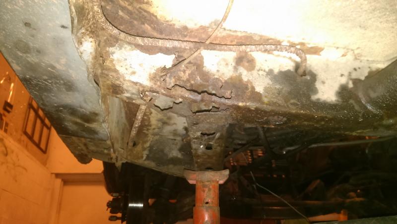

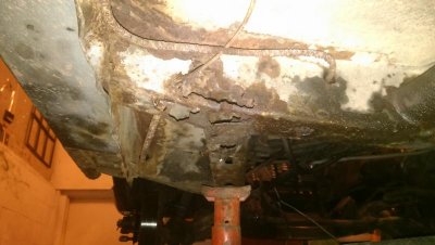

Have a 1966 Plymouth Belvedere with a rusted out torsion bar crossmember ends .
buddha bill
New Member
11:09 PM
Mar 24, 2014
3
0
PA
I have a good floor and don't want to remove it .
can I cut the rocker tabs off the new cross member and install it from underneath? IMAG0235.jpg041.jpg043.jpg
Hi buddha bill, kinda hard to tell unless you give us some pictures of the job you're looking at.
By the way I missed your intro on the welcome wagon, so :wav:

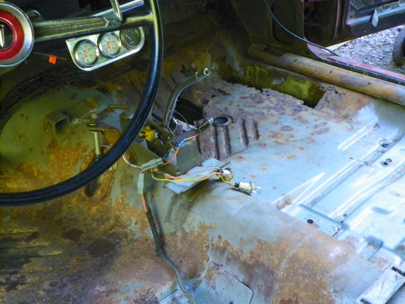

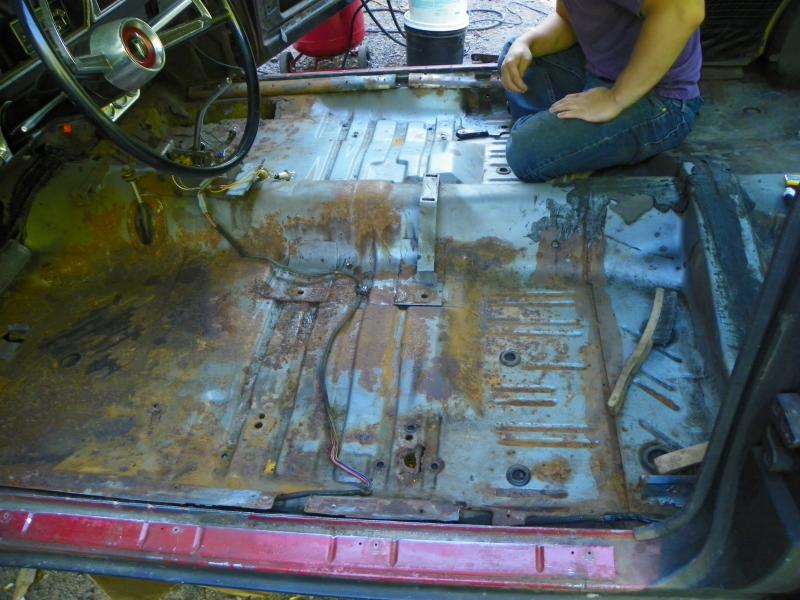

I think what you propose is certainly possible. Having replaced floor on my 66 Bel, it seems that drilling out the spot welds from inside the car & attaching new under parts would be easier.
